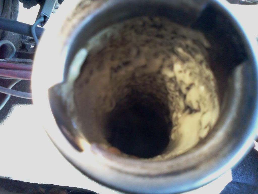

November 25, 2011, 06:22:46 am »
mine looks like this does yours look the same from the oil fill tube?

November 25, 2011, 09:59:47 am »
M-A-Y-O-N-N-A-I-S-E !
