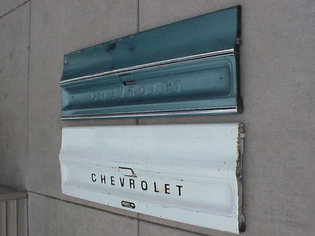

These are mid/late 70's gates.  I believe the white one is more mid 70's (maybe 75/76), while the green one is a late 70's (maybe 77-80)...

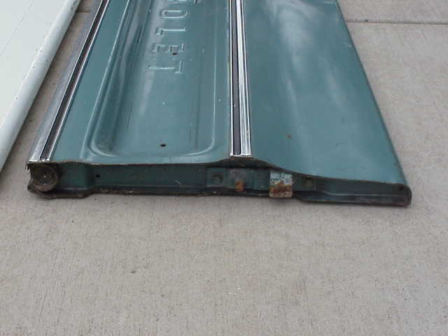

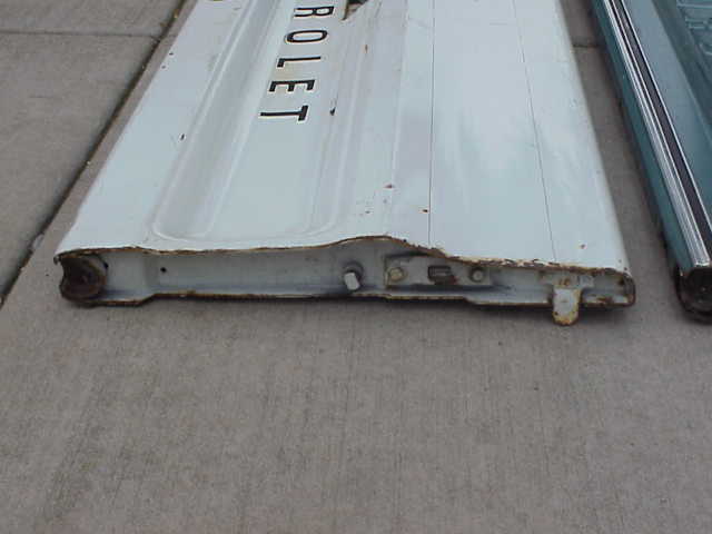

Here are comparisons of the latch assembly on the gates...

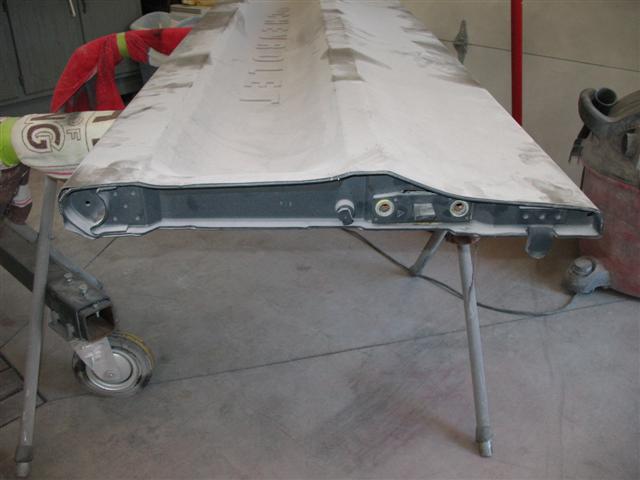

I tried to get a pic of my '73 gate, which is currently bare steel, but it didn't turn out...I'll try again later.  Until then, here is a picture of it from the side...notice the differences in the bottom trunion...

im pretty certain the white one is 76-80, the green one is 81-87
i'm 99% sure  the green one isnt 81-87

The 81+ gates have a more boxy recessed are with the raised script to the right side....not centered.

I don't have pics, but from what I know, I believe it should break down like this...  Please feel free to correct me.  I do know 100% that 73-74 is unique and I am 100% sure 75 and 76 are the same (I have had both in my posession..)  There WILL be some early 75's that are like the 73-74....
73-74 (no quick release)
75-77 (white one pictured) first year of quick release
78-87 (Green one pictured)
Jeff, as you can see there are 3 holes in all of them, I believe that they are the same position just the later ones use only 2....

The one difference that has not been mentioned is the bottom lip. In '81, I believe it went from rounded over to more like a bottom of a door, this does not effect anything, but since were talking about differences. The pictures are a little hard to see, but the White one looks like '75-'76, if it's a "quick change". The Green one is the '77-'80, In my opinion. The older gates ('76 & back) had welded on pins for the straps,ect. right? And the '77 & up were part of the longer latch. You need to replace the bed half to match during the swapping somewhere along the way. I have an original '85 with original paint if someone would like me to take a picture of it to add to the collection.
