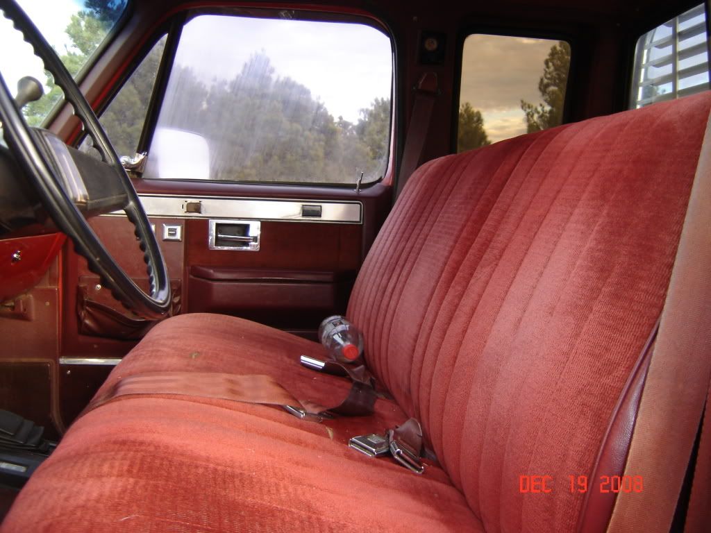

Before

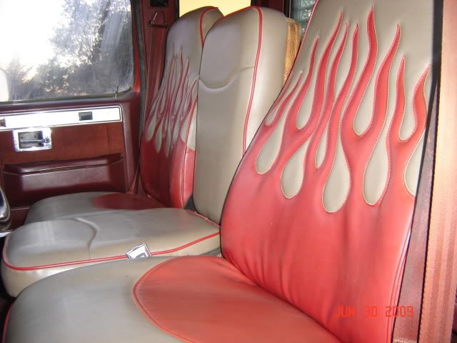

After- still not completely sure about them, but they do give me alot more leg room, and easier access to the back seat of the cab.
I have to work some wrinkles out of the sides, but otherwise they seem ok for $300
