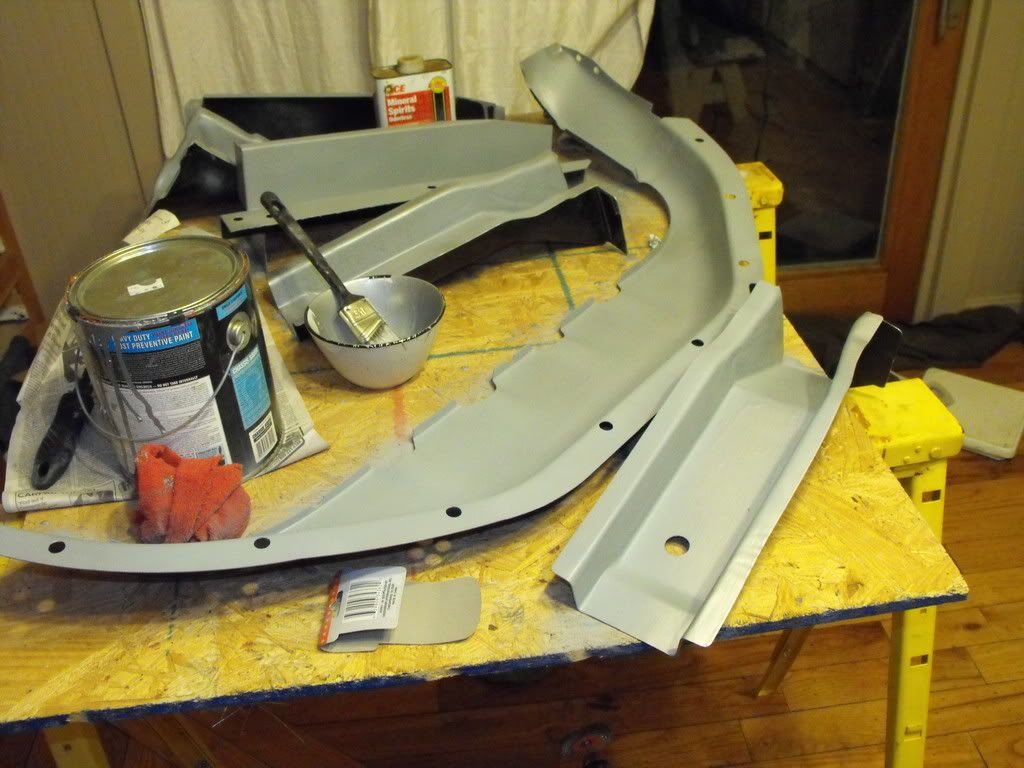

« Reply #17 on: January 09, 2009, 09:00:58 pm »
Here is some Chassis Saver brushed on
