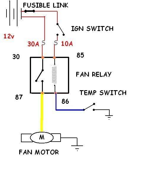

Woah, You're doing it all wrong. No relay? No circuit protection? Did you see the schematic I drew up for it?
Re: Electric Fan Install
« Reply #13 on: March 22, 2009, 07:30:45 pm »
Try this

No, it came with a relay with a fuse, that's what I used. It said on the relay where to hook up each wire.
Red- Battery Positive
Yellow- Ignition Positive
Black- Ground
Blue- Fan Positive 1
Orange- Fan Positive 2 (this wire has a fuse in it.)
Green- AC clutch (not used)
 Sorry, it's hard to be clear when I don't know much about this stuff.
