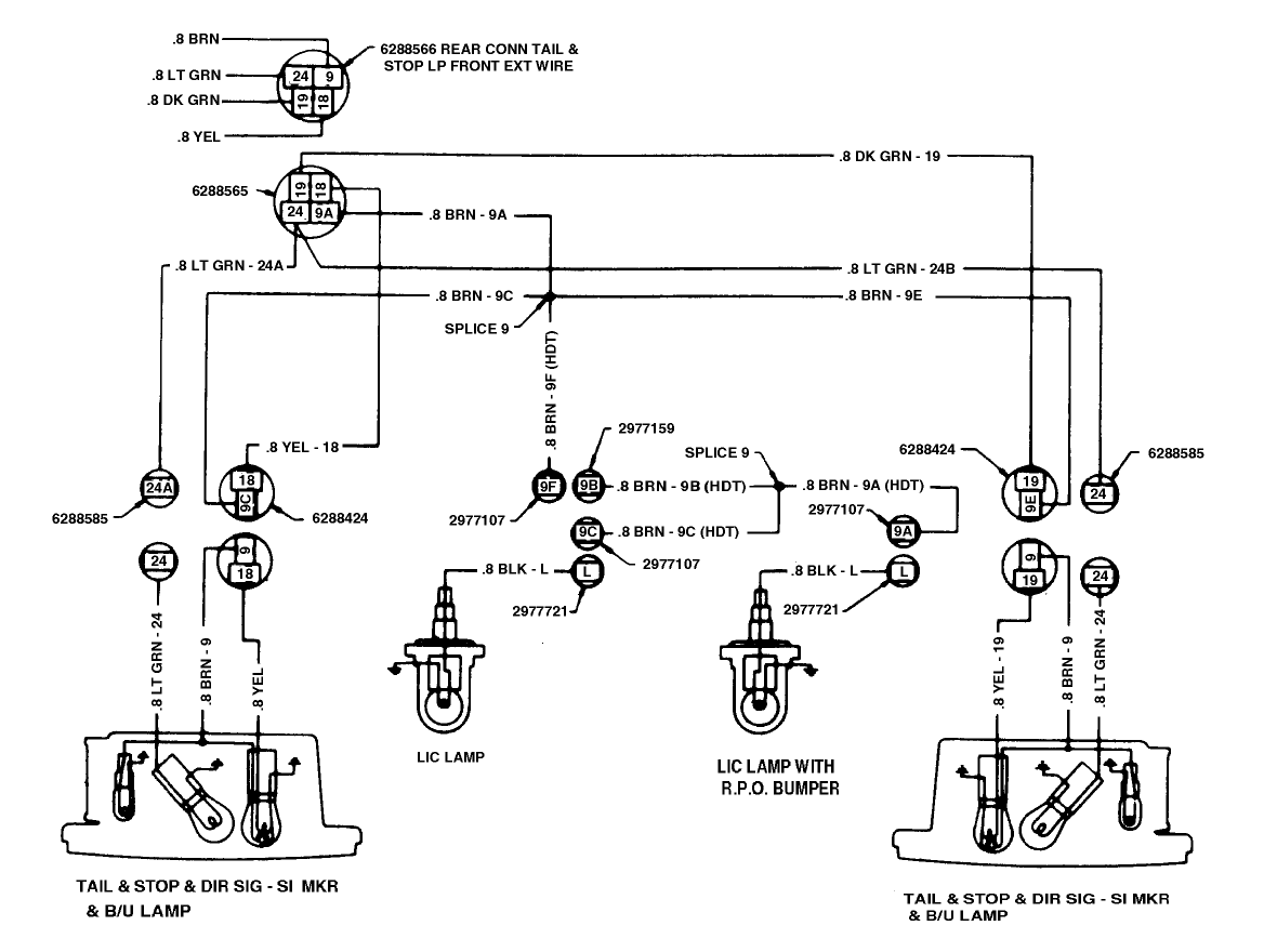

I don't know that it would matter in this situation, but make sure your ground strap is hooked up.  See picture:
Re: Light problems
« Reply #10 on: March 31, 2009, 07:04:45 pm »
Direct link
click
