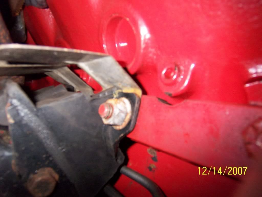

Ralph, I belong to an Olds site, at times I see guys mention that they have some. I can put a post in the "Wanted section" if you would like. The 403 Firebird's had a similar mount design, you may check those out, they were much more plentiful in the day. I have made a couple sets for my Olds powered trucks. The basic design is flat stock across the Three mounting bosses on the block with some version of mounting the upper half to it where you need it to line up over the bottom half on the crossmember. Here are a couple photos. If you need any futher help, just ask! Lorne

Ralph, The diesel upper mounts are all metal. The flat plate in my drawing goes on the block & there is another bracket type part that slide down over the Chevy lower rubber half (I didn't know for sure it was the exact same one, but NAPAonline shows it to be) that the through-bolt slides in. I have the Firebird mounts I could take a photo if you want, they are similar. On mine, I'm using Olds upper & lower mounts. A guy I know welded the Chevy clamshell onto a homemade 3 bolt plate & used the original Chevy lower mount. More than one way to skin the cat. You are also going to need a BOP transmission case or an adapter.

Ralph, Yes, those are the 403 Firebird ones, very similar to the Diesel. The word "solid" is mis-leading, the bottom half has the rubber like the Chevy mounts, unlike the Olds mounts I used with the rubber in the top half. I put a post on one of the Olds sites in the "Wanted" section, we'll see if we can scare up a set for you. The measurement from the front hole to the stud won't really tell the whole story...I used the early Olds 2 bolt bottom half & drilled the holes in the frame brackets to match, kinda set the engine in, figured the placement (partially by the A-body headers) marked this & that, then took it back out & finished them up.
