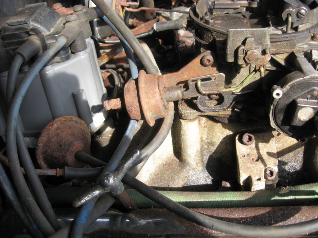

i am still working on cleaning up the engine bay on the 82 (lots of work!!)  and i need help identifying this part.   also, what is it's function??
there are some vacuum lines that run to it, they come from the manifold vacuum behind the carb.   i have probably 4 different vacuum lines coming out of that port,   is this to much?   i know that the transmission vacuum line runs into it.  (possible reason for late 1-2 shifts?)

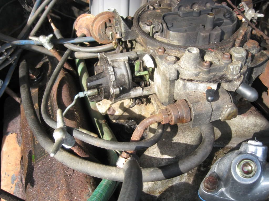

lastly, i was having problems with starting the  truck (very rough intitial startup, after engine warms up starts fine) and came to the conclusion it was the choke, so i tied the choke open.   this solved a couple issues:
truck starts much better, no rough initial startup,   and now my secondaries are operating properly. ( wouldn't open previously)
is this a problem with the electric choke, or with the linkeages?
i would like to fix the choke, the winters are cold and it is a plow truck.  summer startups are fine.

Pic number 1 is your cruise control.
Take a pic centered on your choke, it doesn't look like the elect. connector is pluged in. I can barely make out what I think is a spade connector at the bottom of the choke housing.
Hey, is that a section of garden hose running down the length of your intake manifold?  ???

i'm not even sure if the cruise control works,  i might end up removing it,  the sock that's holding it in is getting a little rough....  (sock provided by previous owner)
this is a pic i have offhand of the elec. choke.  spade connector is in, and has power when key on.  all linkage operate smoothly by hand, not sure if they are working right on their own.   i tied the green tab and the silver tab above it wide open.  not sure if it makes a difference, but it has an edelbrock intake, not sure which one.  (how can i tell?)
yes that is a garden hose,  i guess a makeshift heat shield?!   (also provided by previous owner.)
also, can anyone tell me if my vacuum advance is plugged into the right port on the carb?  what about the other hose from the valve cover, what is that for?

Looks like vacuum advance is in the right place, that's a later carb than mine. You might try the port above the fuel filter and see if it runs better.
Take the cover off the choke and see if the bi-metal coil is broken or disconnected.
The hose from the valve cover is vacuum for the pvc (Positive Crankcase Ventilation) system... keeps presure from building up in the crankcase from blowby.

does the speedometer run through the cruise control?   i may end up keeping it,  can anyone tell me where in the engine bay it is typically mounted?   mine is currently resting on a sock on the inner fender,  pretty sure that's not how it came from the factory.
