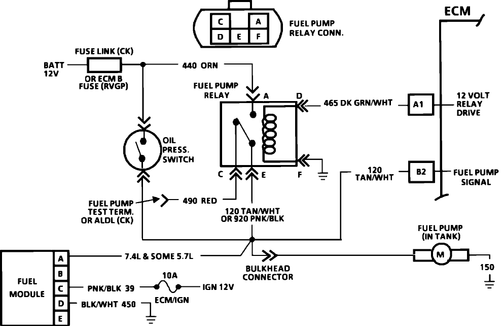

« Reply #3 on: May 27, 2009, 12:49:56 pm »
All you have to do is hook a jumper wire up to the pigtail hanging off of the fuel pump relay. This goes directly to the b+ side of the pump so hook it to battery b+ and the pump will energize. That will allow you to operate them pump. Just keep an eye on it. When it stops pumping shut it off otherwise you will burn up the pump and have to drop the tank anyway.

« Reply #7 on: May 27, 2009, 04:28:29 pm »
Cavity C of the fuel pump relay is the jumper lead.

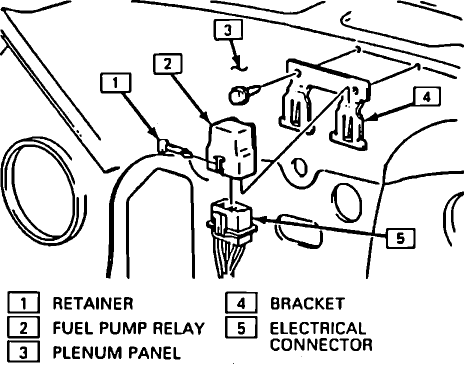

« Reply #8 on: May 27, 2009, 05:48:18 pm »
it is right by the AC unit on the firewall at the top (as pictured)

« Reply #10 on: May 28, 2009, 07:32:29 pm »
Just to be sure I have this right...jumper from bat + to the c terminal will run the fuel pump...right?
Re: draining bad gas
« Reply #11 on: May 28, 2009, 07:57:03 pm »
yep
