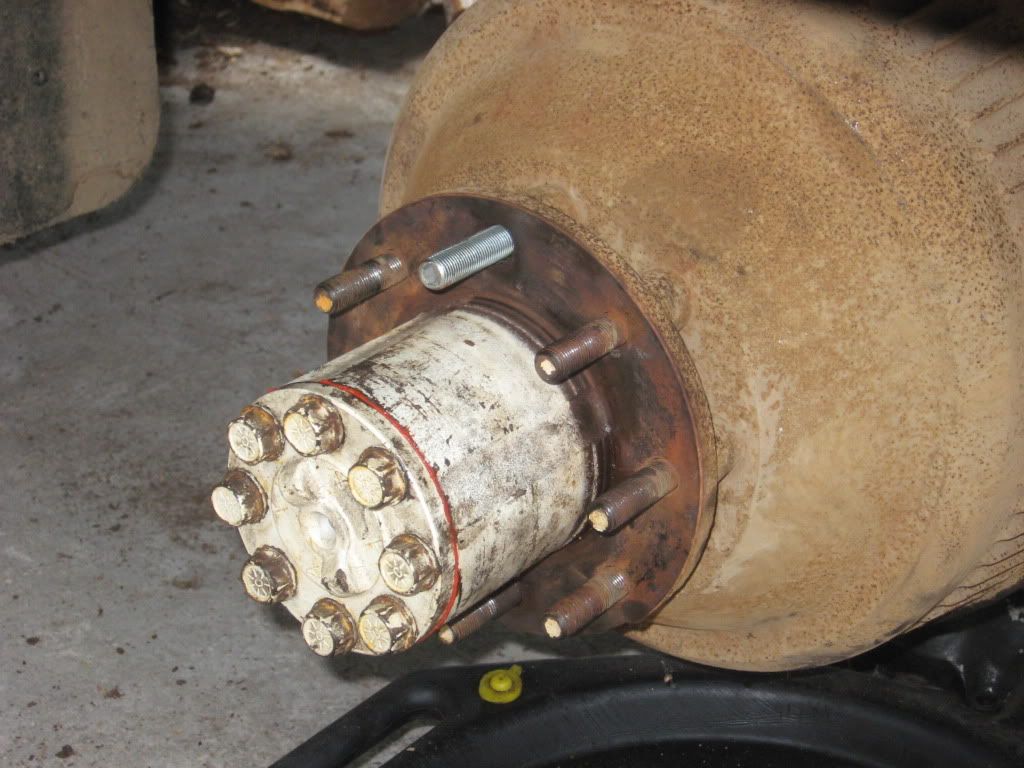

hello all, I had to change a lug that broke on the rear drum of my truck, everythging went ok but cannot seem to find the torque specs for the bolts in the picture, i think they are called the axle flange bolts but not sure.
thank you
jim

Naturally, the torque spec depends on the dia. of the stud and the material it's made of. A common spec for 1/2-20 studs is 77 lb ft torque when a grade 5 stud is used.
http://www.hotrodheaven.com/store/brakes/pdf/140-6293.pdf
Don

115 ft.-lbs

Those are probably Grade 8's... For a 1/2-20, torque is 92 ft-lbs.
