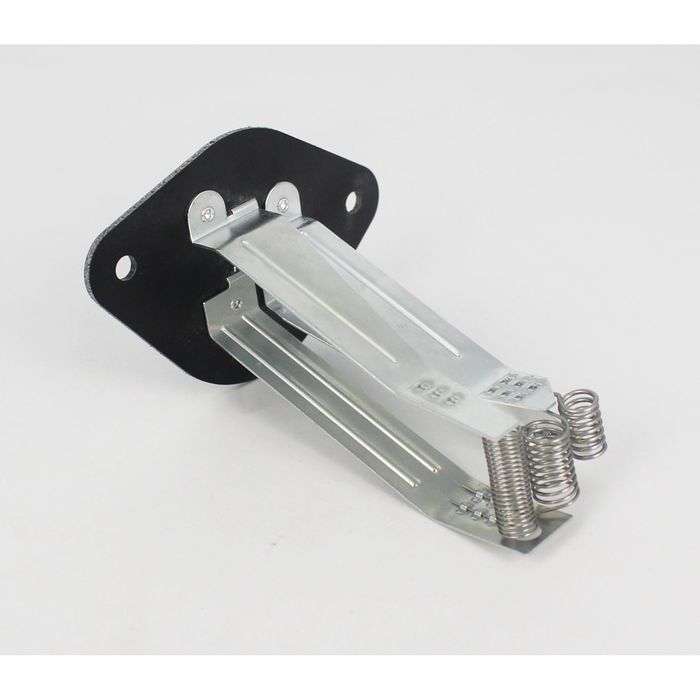

OK heres my problem the PO or maybe me (accident) disconnected the fan switch on the dash so its hasn't work for me just the fan stays running on very low. finally took it apart the other day and tried to figure out what post on the switch did what and i found out
I(+)
L(H) I(L)I(M)
or something like that did some research on here found the wire diagram then looked under my dash and tangled in some other wires i found the pig tail hiding. plugged it all in and it works fine so i turned it off and went to try it again and it doest work, but the fan is still moving in very low. so i check the power in the switch its only 4.5 not sure what is suppose to be did check before this problem. i check the power to the fan its about 11.5, now knowing if i hook a jumper wire strait from the bat. to the fan it runs fast the 11.5 and it still being very low did make any sense so i jumped it and it ran fast so its not torn up. now whats my problem?

« Reply #5 on: December 19, 2009, 01:24:52 am »
OK taped on the relay looking thing fixed it, then i switched it back off and it did it again so i played with it by taping everything and as long as you tap the a/c housing it turns it on I'm thinking its this which is at the top of the a/c housing its the blower motor resistor. now even after taping this it only works in high nothing else beside the low-low

« Reply #9 on: December 20, 2009, 01:49:16 am »
Yes, I tap ped it, as in banged on it lightly. It not the resister as shown in these pics above. Its a little metal box, I am assuming is a realy in the vicinty of the resistor though.
