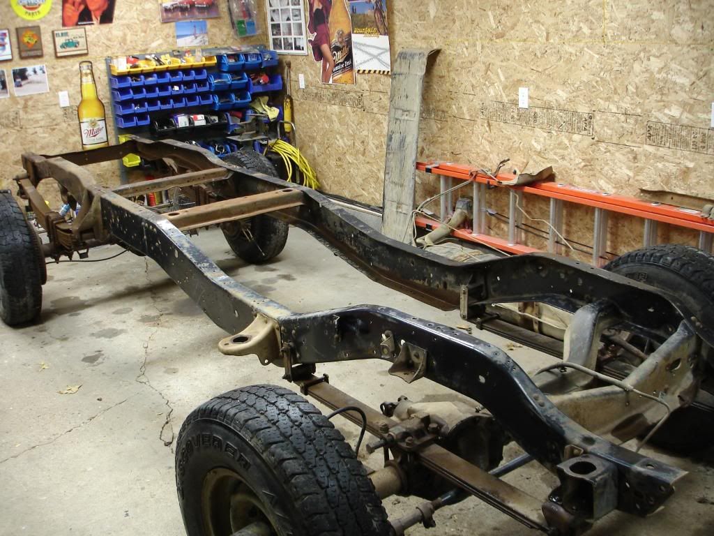

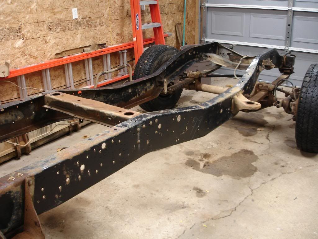

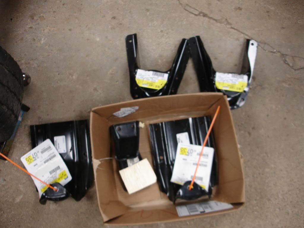

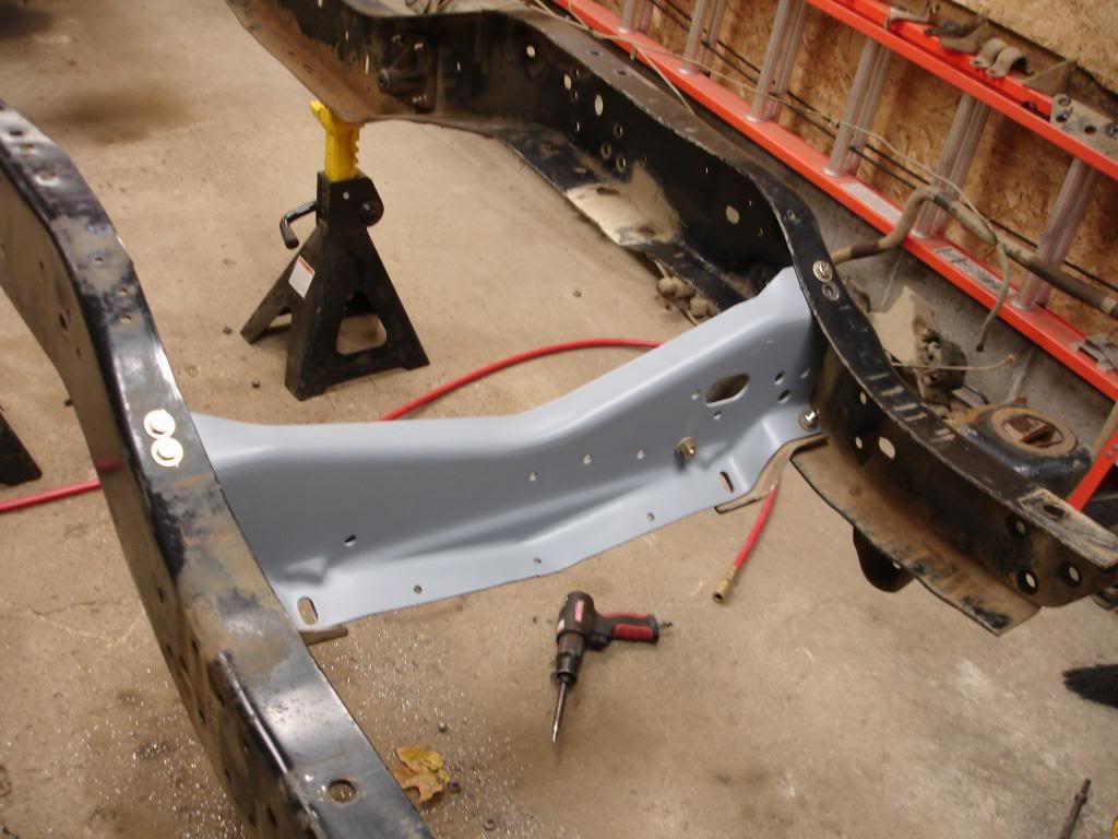

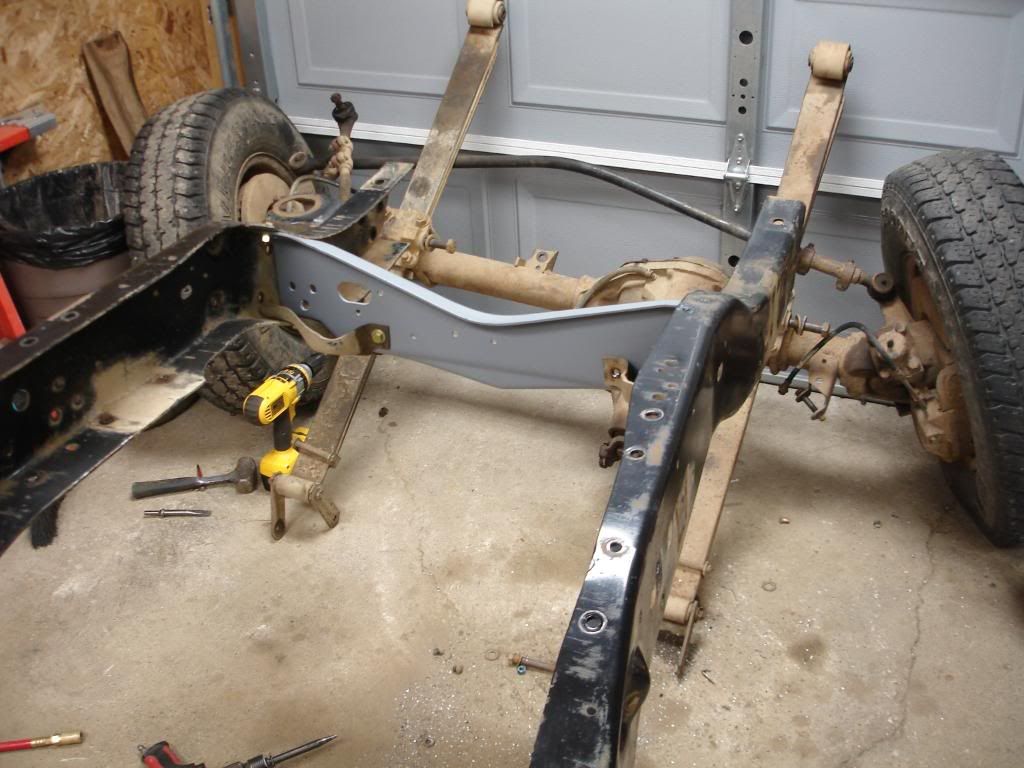

Down to just getting rid of rivots now.  Started washing it up today and still a lot of black left on the old girl.  Got quite a bit of the rear frame pieces nos gm on order.  Hopefully they can get what I'm asking for.

Replaced the very front crossmember with a nos member to get rid of some fork truck damage.  I also got in some nos spring hangers and suports.  Looking into a few more nos crossmembers.  Trying to get rid of as much rust as I can.  oh, I only have 10 rivots left and will have them all out  ;D

 Kool good parts truck, make sure you reinforce the steering box area on the frame while ya got it apart. I'm getting parts ready for a new frame for old rusty. Going to do the stock 2 WD rear spring hanger flip, so I can remove them stinkin blocks from the rear end. 2WD steering box/crossover steering, and I'm taking out the 52" springs in the rear and putting in 56" springs. Nice job, keep us posted.

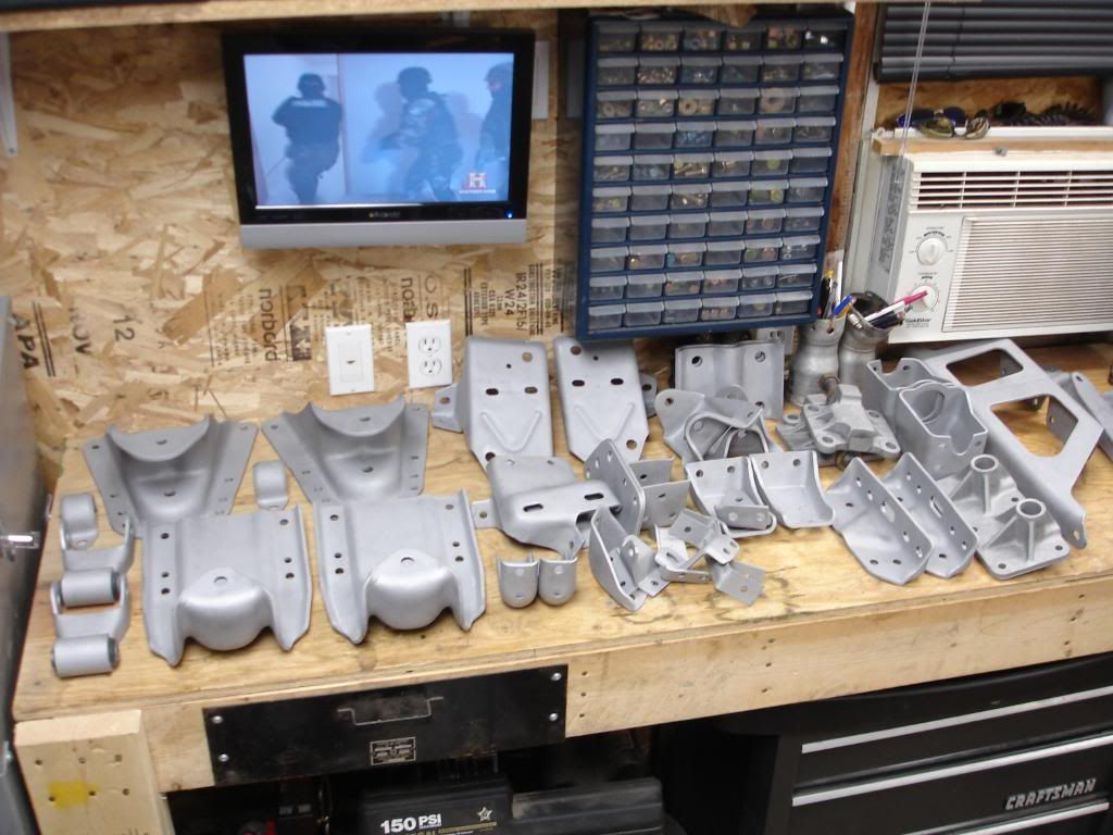

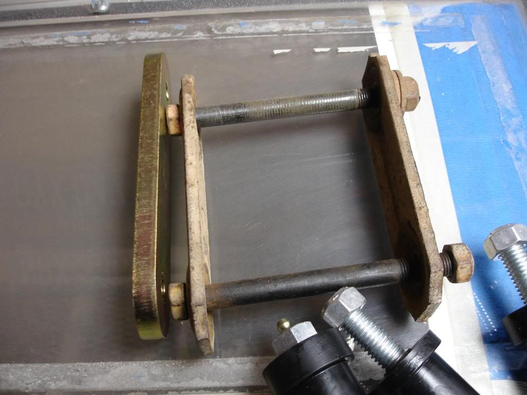

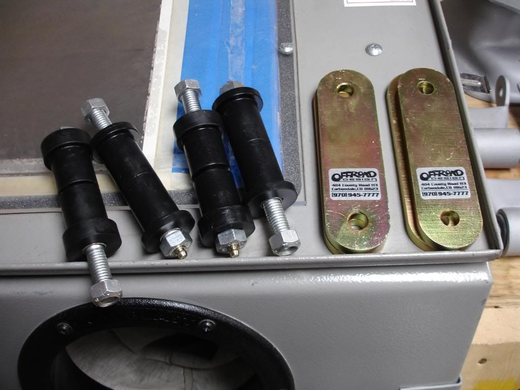

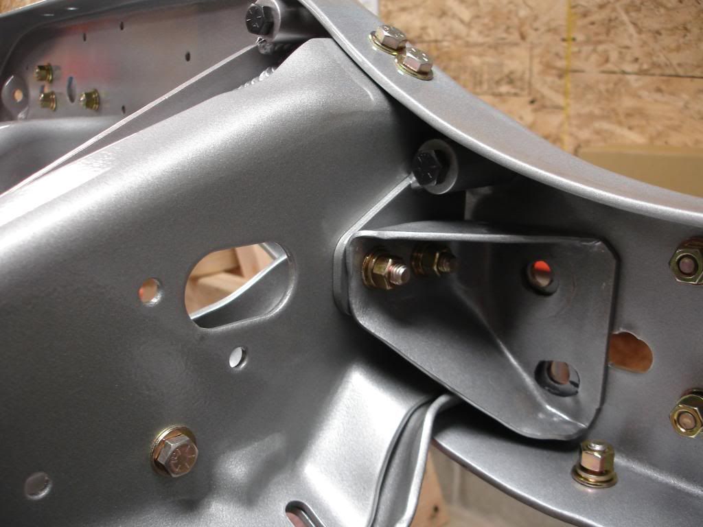

I got an offroad design steering box brace and front rear spring shackles for it.  I have almost all the parts ready to go to powdercoat next week.  Should be ready by the end of this weekend.

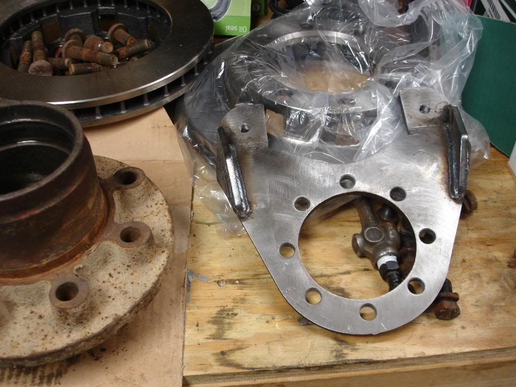

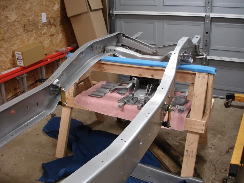

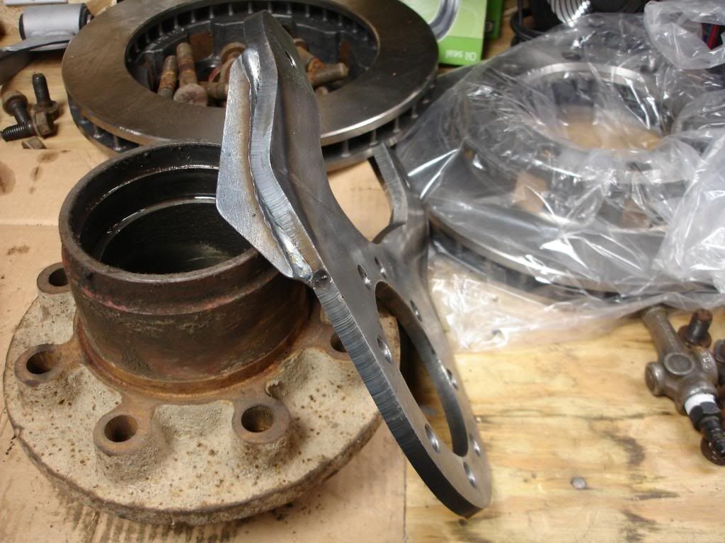

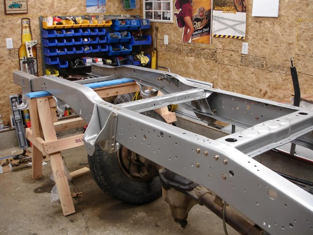

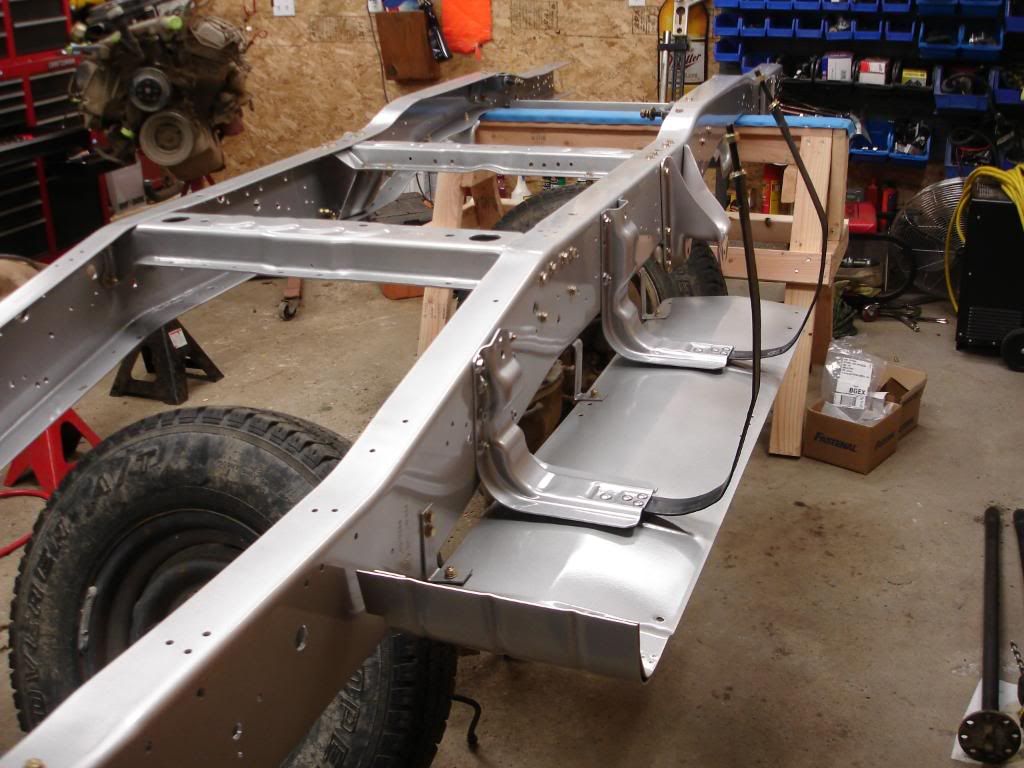

Here are some updated photo's of my project.  Most of the powder coating is done.  Starting to work on the axles now, disk brake conversion for the rear.

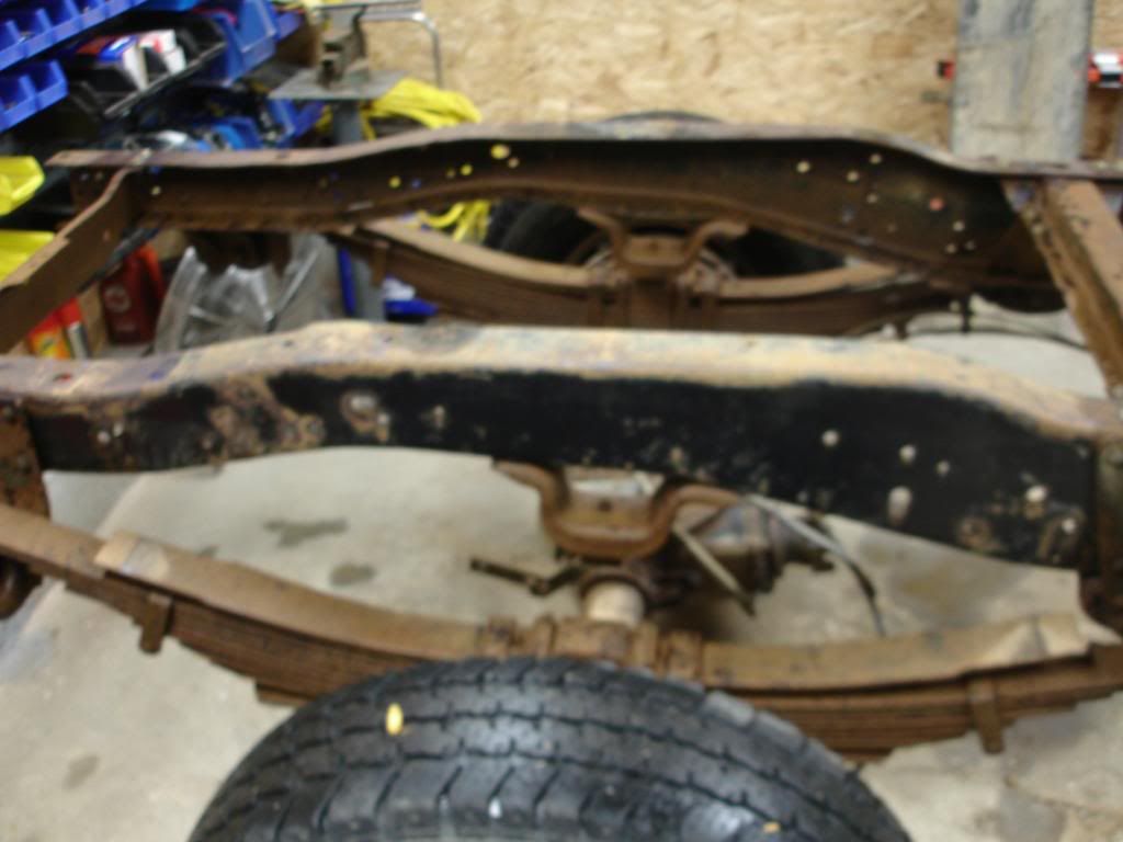

This is gonna be a cool truck.question tho,why did you take all the rivits out ???
This is for my blue truck, I have already done a frame for it and the truck is complete.  It bleads rust real bad between the parts.  I wanted to coat all the way around everything.
