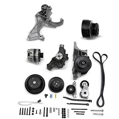

Morning, I was looking for a new crank pulley on the Summitracing.com and came across a serpentine belt kit for trucks like ours for 770$ A little pricey but you get every thing you need to convert it over including a A/C compressor, power steering pump, alternator and water pump, plus all brackets,pullies and hard ware. Not a bad deal for some like me who has only a limited amount of time to work on his ride. My question is, has any one used this kit before and which side does the A/C compressor set on? Thanks for any and all input on this subject and just incase your wondering what the weather is like in Iraq, Well after 120 we stop keeping track of it!  Below is a copy of the add on the Summit website:
GM Performance 12497698 - GM Performance Deluxe Serpentine Drive Kits
 smaller image
•   $769.95
•   Call to Order
•   + wishlist
•   + compare
•   Pulley Kit, Serpentine, Steel, Black, Chevy, Small Block, Kit
 Estimated Ship Date: Tomorrow
•    Email this page
•   Overview
•   Application
•   Show All
Brand      GM Performance
Manufacturer's Part Number      12497698
Part Type      Pulley Kits
Product Line      GM Performance Deluxe Serpentine Drive Kits
Summit Racing Part Number      NAL-12497698
Pulley Style      Serpentine
Pulley Material      Steel
Pulley Finish      Black
Crankshaft Pulley Included      Yes
Crankshaft Pulley Grooves      6-groove, serpentine
Crankshaft Nose Cover Included      No
Water Pump Pulley Included      Yes
Water Pump Pulley Grooves      Non-ribbed
Water Pump Nose Cone Included      No
Power Steering Pulley Included      Yes
Power Steering Pulley Grooves      6-groove, serpentine
Power Steering Pulley Attachment      Press fit
Power Steering Brackets Included      Yes
Alternator Pulley Included      Yes
Alternator Pulley Grooves      6-groove, serpentine
Alternator Fan Included      Yes
Alternator Nose Cover Included      No
Alternator Brackets Included      Yes
Air Conditioning Pulley Included      Yes
Air Conditioning Pulley Grooves      6-groove, serpentine
Air Conditioning Cover Included      Yes
Air Conditioning Brackets Included      Yes
Idler/Tensioner Included      Yes
Idler Cover Included      No
Idler Brackets Included      Yes
Hardware Included      Yes
Bracket Finish      Natural
Bracket Material      Aluminum
Quantity      Sold as a kit.
Notes      This kit includes an A/C compressor, a long reverse-rotation water pump, and a power steering pump.
Efficiently control your entire engine assembly.
These GM Performance deluxe serpentine belt drive kits include everything you need for installation.
Kits include:
* Bolts, nuts, spacers, and brackets
* Water pump with pulley
* Crankshaft pulley
* Serpentine belt
* Alternator
* Drive belt tensioner assembly
* Power steering pulley
