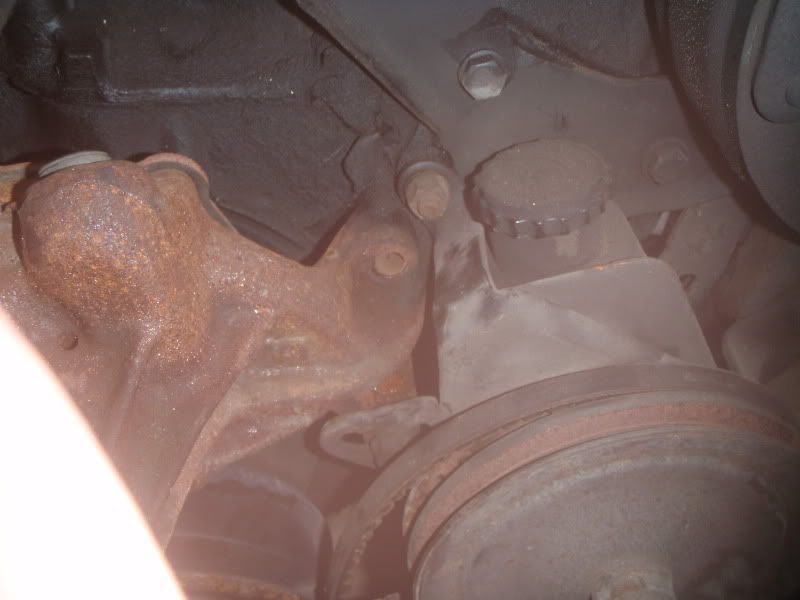

Re: power steering?
« Reply #2 on: July 21, 2010, 05:50:40 pm »
the holes are on the water pump for the power steering mount.

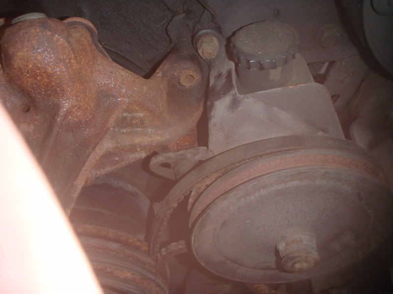

« Reply #4 on: July 21, 2010, 07:14:21 pm »
I guess I could have moved the broken belt.

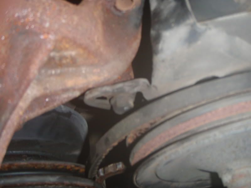

« Reply #5 on: July 21, 2010, 09:36:34 pm »
hey texasred is that bracket using one of the holes on the head too?  Does it bolt down anywhere near the bottom of the block or is it just at the top and on the water pump?  Thanks guys, now I just have to find the bracket I guess.
Offline TexasRed
  • Posts: 727
Re: power steering?
« Reply #6 on: July 21, 2010, 10:05:00 pm »
It appears to me to be one on the head and one on the water pump. I don't see a place for two on the water pump. I don't think it connects to the bottom of the block. I can check again in the AM.

« Reply #7 on: July 21, 2010, 11:57:18 pm »
yea sorry I see it now, yea one on the head and one on the water pump.  Yea if you can look on the bottom for another bolt that would be great.  Thanks man!

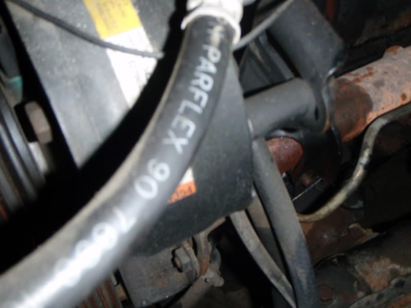

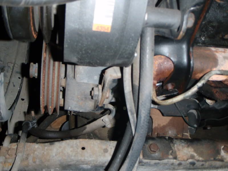

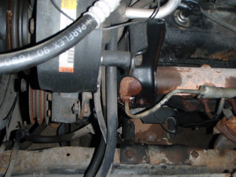

« Reply #8 on: July 22, 2010, 01:26:43 pm »
There is actually another bracket on my pump that hooks up to the A/C compressor bracket bolts up to the exhaust manifold. I'll take a picture when I know it won't rain later.

« Reply #10 on: July 26, 2010, 12:16:25 pm »
this is from a '91, but there is a bracket the pump bolts too as well on the 350
www.delbridge.net/powersteering.html
