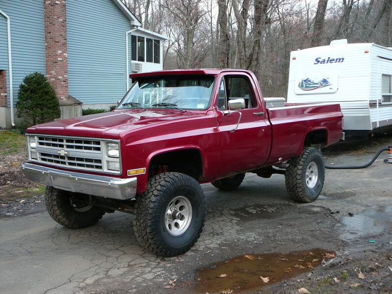

« Reply #7 on: July 18, 2010, 09:20:02 am »
heres mine with 6 inch lift, 38 inch Super Swampers. Driveshafts work ok,but I would lengthen them if you are gonna do any serious offroading. I removed the clips that hold the hard brake lines in place, and bent the hard lines down a but. This is only temporary until i can get the new lines in. Driving straight, and normal corners, everything is fine. Mine rubbed when I hit bumps going into corners. If I trimmed the lower corners of the front fenders, everything would have been ok, Im just not into butchering this truck.

« Reply #10 on: July 18, 2010, 08:56:22 pm »
Thanks Swims350, I like it. It no longer has the 38"s tho. I didnt like the rubbing when hitting dips in corners so I went with 35's. I want this thing off road capable whether I take it off road or not.Never know when the urge may strike to go mudbogging. Here's how she sits now.

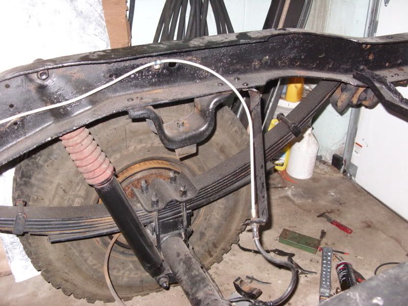

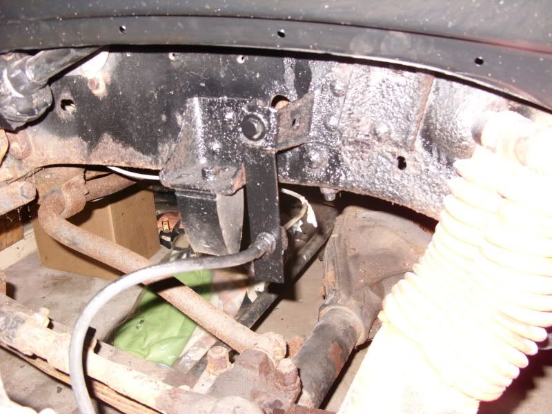

« Reply #11 on: July 23, 2010, 10:50:25 pm »
No the lift will be the only thing to lift your truck.
Just make up some brackets off of your frame going lower then the original holes, drill some holes, buy longer steel lines that went to your rubber hoses and bend em to meet the stock rubber hoses in the bracket's holes. Thats all I did, it was easy, and I replaced alot of steel brake line that were rusty.
Im not sure about the driveshaft.
I have 37 in tires with a 6 in lift on my 87 Chevy and it clears them, but I wouldnt go any bigger. Go with Pro Comp 37's, there prices are decent and the tread is aggressive but works well on the highway.
Heres some pics of what i was talkin about (first two of the brake line brackets, rear is welded on, front are bolted onto a bracket allready existing on truck, 3rd picture of my truck sitting on 37in Pro Comps
