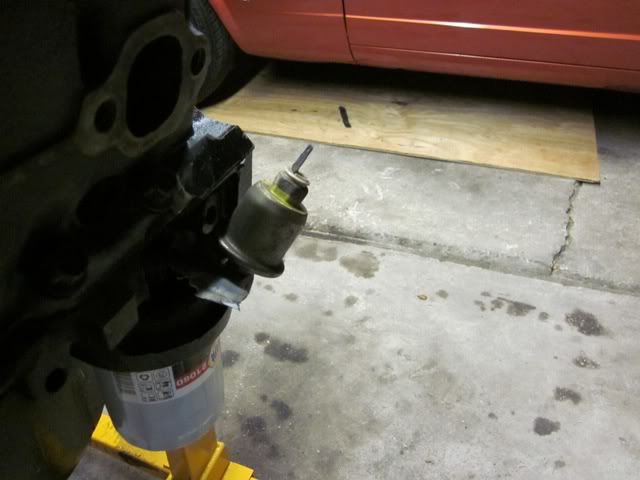

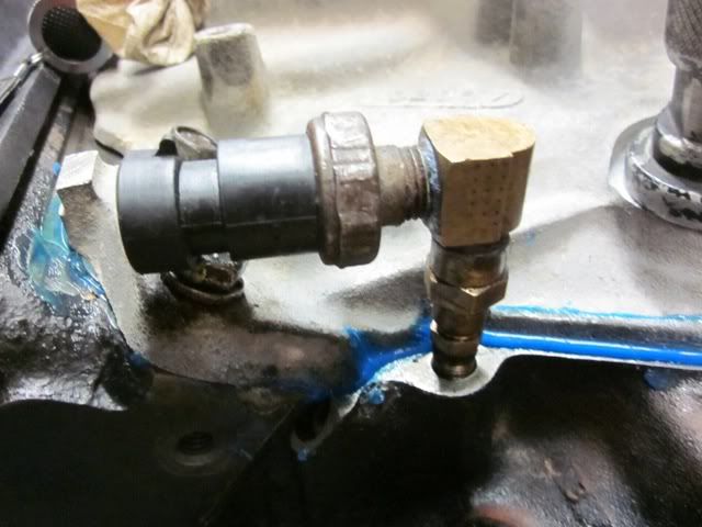

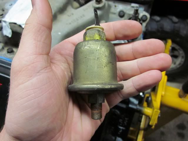

Hey guys I got my new motor and I have a few questions. I know there's controversy between the ways the break in a new engine... Does anyone have any tried and true methods to break in a new engine? All I know is not to use synthetic and to run it hard! Any light on this subject is appreciated, I plan on having it running in the next day or so.
My first question concerns this part... I know it has something to do with the oil, but I also have what I think is a sending unit next to the distributor behind the intake... So what's the purpose of this one?
Here it is in place
Here's the sending unit (I think). So this is what is responsible for what I see on my gauge?
Thanks for any help...

Re: Pulling my 350! Pics!
« Reply #25 on: October 06, 2010, 03:38:57 pm »
top = ECM
Bottom = Guage
« Reply #27 on: October 10, 2010, 12:48:50 am »
Break in the cam -we just had a post on this (search) 20 minutes. Change the oil and filter then onto Breaking in the rings... Make sure you vary engine speed and moderate acceleration to WOT within the first 50 miles.
Oil pressure switch near distributor for ECM oil pressure sending unit for gauge.
