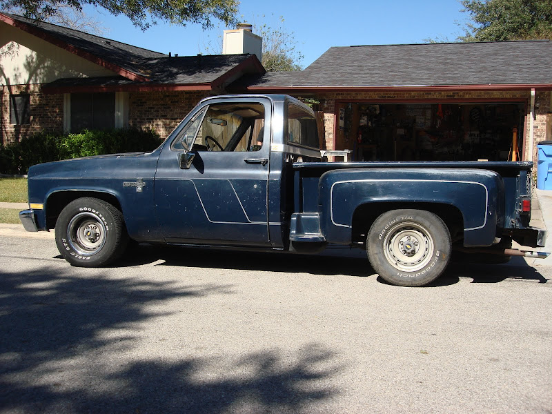

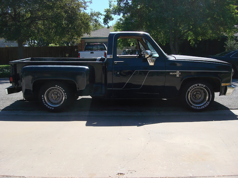

Here is a couple of pictures of the DJM kit I just did - 3/5 drop. I have not driven it as it isn't aligned. I think the front will settle down some once that is done tho..
Before de-bar'd ;)
Dropped and cleaner. Next, alignment and off to the body shop while I rebuild the motor...

what size rims/tires you running? and did you just do a 3" drop spindle in front and a 5" flip kit in the rear? i like that stance. looks ready  >:(

Those are 275/65 15's if I remember correctly.
I only did the spindles and flip kit, no coil spring change or shackles.
Thanks man, I can't wait to get working on the interior and then off to paint, then a 350...
