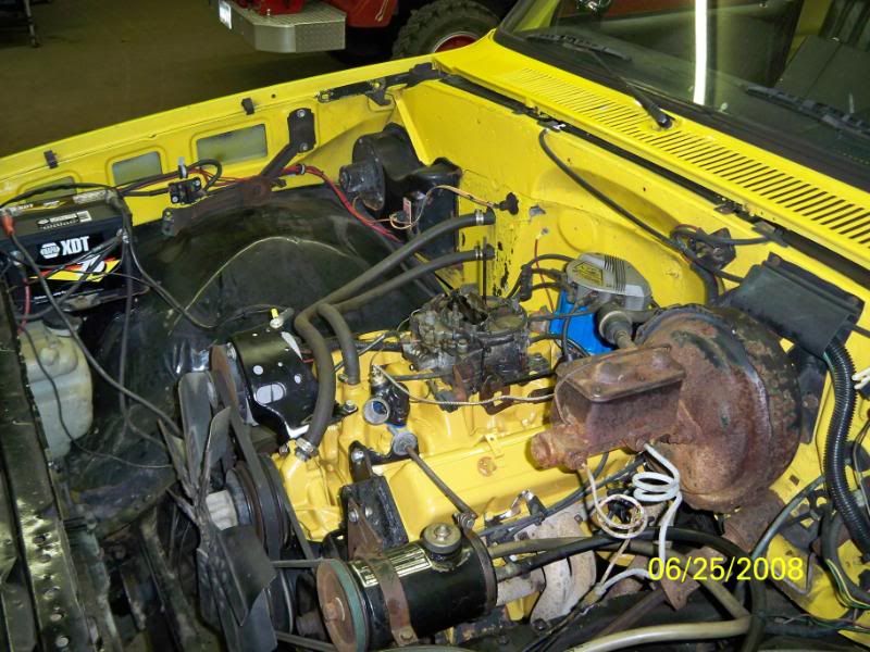

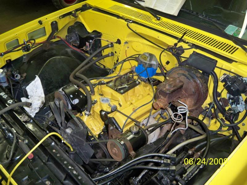

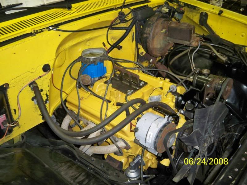

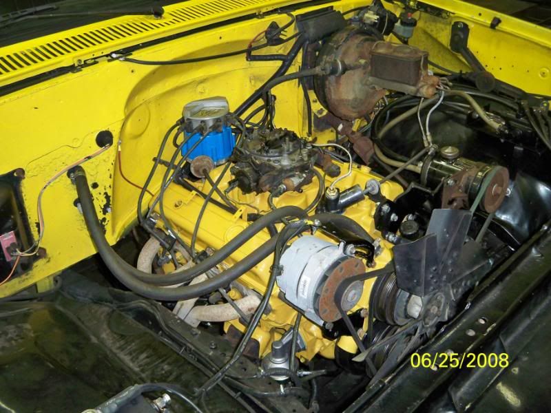

Its in, it runs, still have to do a little tuning, and I have a noise coming from the bell housing area??

Brand new through out bearing! I am going to investigate this week one night.
