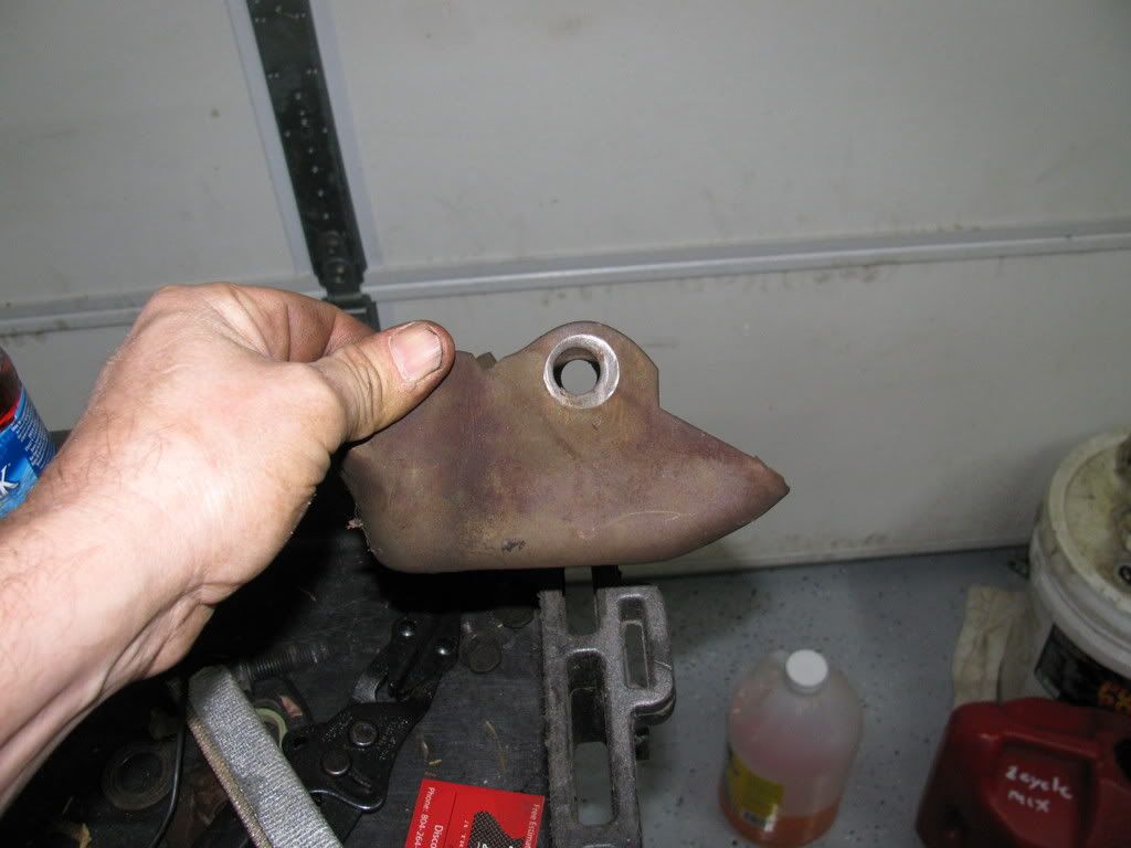

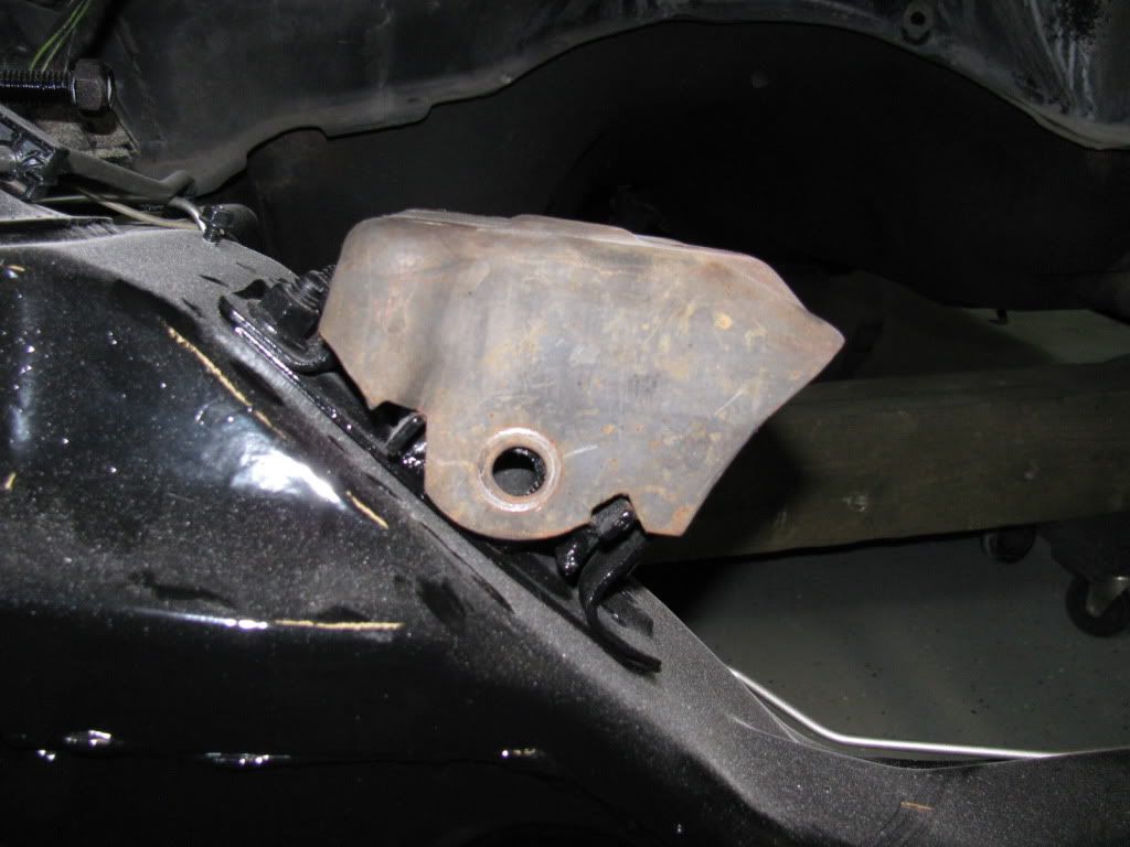

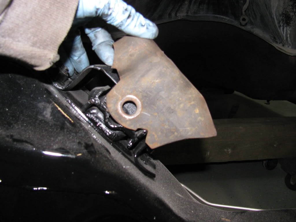

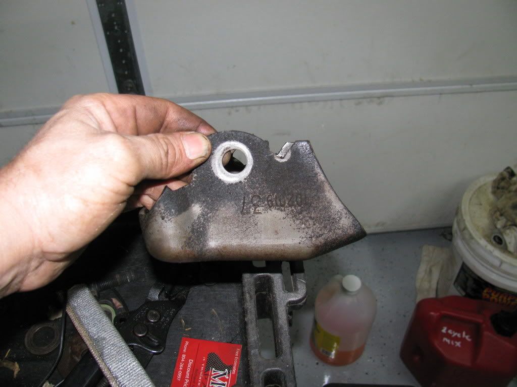

the passenger engine mount can not be used with Regular frame mounts, Found this out the hard way, But a reguler SBC passenger mount shell will bolt up. I thought I could just flip the mount and use it but it hangs up on the little tabs the shell rides on.
Regular mount shell
Passenger side LT1 shell
Passenger side Lt1 clamshell turned upside down like a regular small block clamshell.
You can see how the tabs cause the mount to not sit all the way down to be able to get a bolt in.
This is how it would have to sit to bolt up to the mount.
