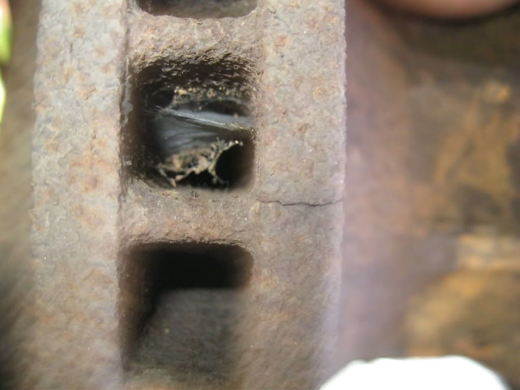

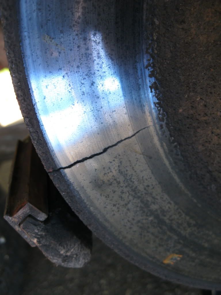

well i had to change my brakes cause the caliper i bought new was locked up. lucky the brake pads and caliper were under lifetime warranty. well to get down to it i was getting the caliper off of the passnger side of my 1 ton dually in the front and i got it off fine i looked and found a crack in the rotor. can anyone tell me of what to do to get the rotor off as its a whole piece. and how the inner barrings and spindle nuts go or should i take it to a good mechanic or friend that has built his own chevy drag truck from the ground up.
