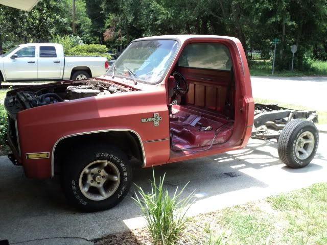

currently 350/700/373. future plans may include a hair drier or 2 and there is definately a new stance and alot of cleaning up to do....

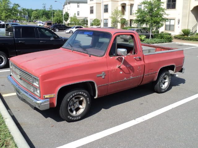

like it was the day i bought it
and where i stopped today.
i would like to see some solid 13s out of the truck N/A, and maybe 11s after some "exhaust" work. thats a ways down the road. i want it to be a clean driver with a/c first. then we'll open up the 350 and start tinkering.

i am SERIOUSLY considering pulling this thing down to a bare frame and going for the total clean and paint. how much of a pain is it to pull the cab?
