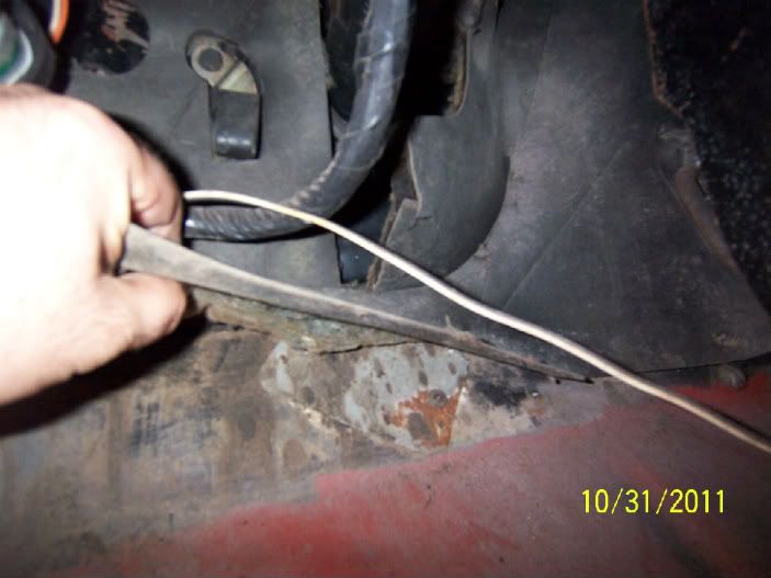

where does the clutch rod come though the firewall.  Would anyone have pics of the hole in the firewall?
I took this the other day to try to help you. The hole does not go through the firewall, it's in the toe board area of the floor. The tin patch in the picture is held on with the Two screws (can only see one in the photo) that originally held the rubber boot in place. It is pretty much straight down from the steering column...In my mind it was farther over to the Left, but it's been 15 or so since I put that patch there.
 I would start by getting the pedal assy. & Z-bar in there. Where the hole goes shouldn't be hard to figure from there but I can measure it for you if you need/want me to.
