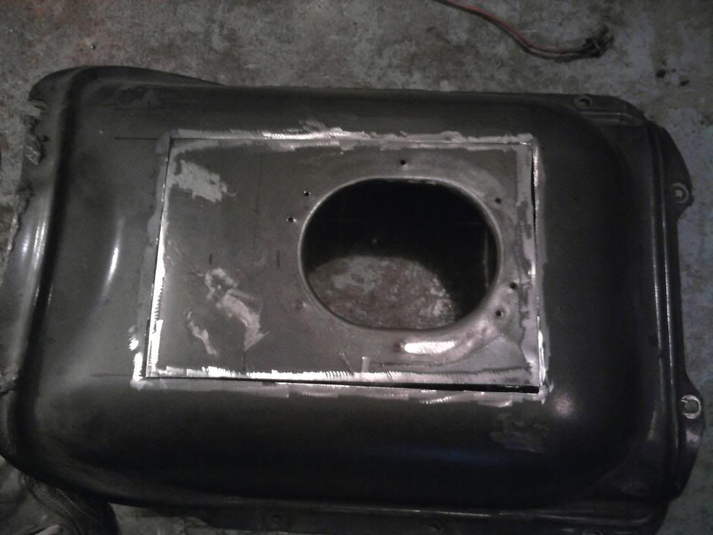

Based on the pictures of your floorpan that cab never had a manual in it.  The hole that Zieg is talking about is missing.

OK i found some holes, I think they are for the bell crank bracket but they might be to far apart? Also here is the bracket that i was talking about that the 3 speed tranny used that my auto lever is going to...
Could i use this bracket with my 3 speed manual?

Unless they replaced the cab, there would be holes for the clutch rod and the shifter. check your rpo codes to see what tranny it had.
