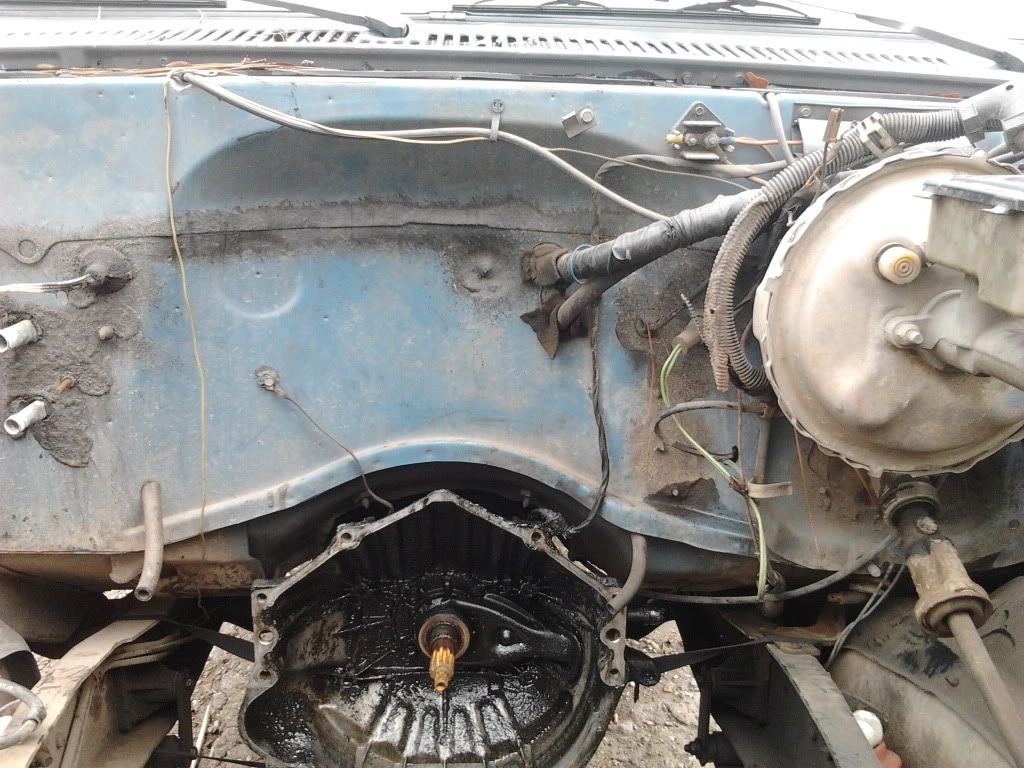

Here’s the situation.  1981 Chevy K10 with what appears to be a dealer installed ac system.  When I got the truck the ac didn’t work (no compressor), but the heater kind of worked, meaning it pushed a little air through the vent VERY slowly.  The back side of the dash control switch was broken so none of the slide levers worked properly, so I can’t say if there is a blower problem or not, but I am assuming there is so it will be replaced.  Eventually the heater core died and dumped coolant on the floor of my cab.  Now I would like to get the AC back up and running but I’m a total retard when it comes to the AC system and I can’t seem to find my same set up on the web or junk yards to help me piece this thing back together.  Here are some pics to show what I have.  Take a look at where all the lines go through the firewall.  This truck originally had the 4.1L straight six and manual tranny (SM465).  Before anyone asks, both are already gone so I don’t have them.  I am putting in a 350 and a 700r4 and a larger radiator (from the 454).  The AC condenser is currently located in front of the radiator. Don’t know if it’s good or not, again assuming it isn’t.  Haven’t even dug for the evaporator yet, based on where the drain line is, I assume it’s in the box in the cab behind the glove box with the heater core, but that’s a guess.

?Liquid and drier? Lines to left of brake booster
So, the question is, will I be able to use the lines as they are now?  I am concerned about the location through the fire wall.
Can you trade out the ends of the lines to fit the newer R6? (pancake) type compressor.  I wanted to go with the R134 set up for servicing convenience.
Most importantly, what do I need to replace when making the switch to 134?

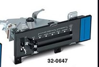

Does the slider look like this...

zieg85 - yep, that's the one.  It hit me that the ac wasn't from the factory when I got the new one.  This is the replacement that I ordered..
http://i1161.photobucket.com/albums/q509/graydog39/newcontrol.jpg
