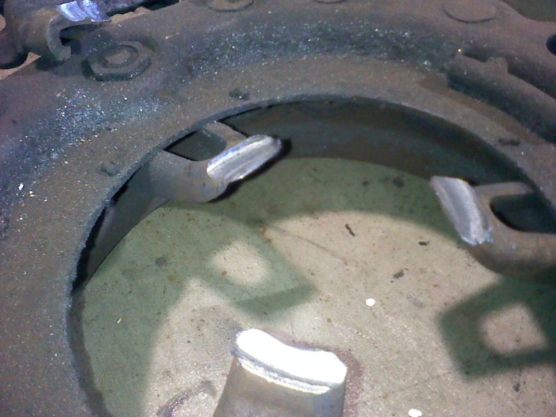

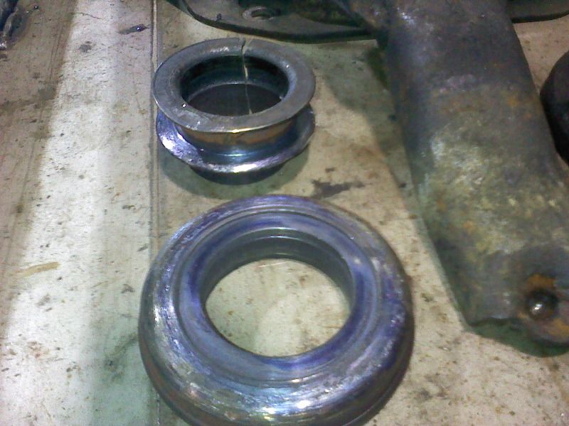

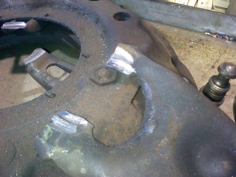

I parked it inside Sunday night, and test drove a customers 98 Dodge 2500 4x4  home for the night. Didn't get to it yesterday, drove it home, and back today. Tore it apart, there was some carnage! Needs a new pivot ball, new arm, new nose cone, new clutch. The bearing ate right into the fingers of the pressure plate. Bearing came out in two pieces, had the cut the inner part to get it slid of the cone. I had a brand new arm in stock. I have a heavy duty clutch with about 1,000 miles on it somewhere, but do you think I can lay my eye balls on it? Heck no!

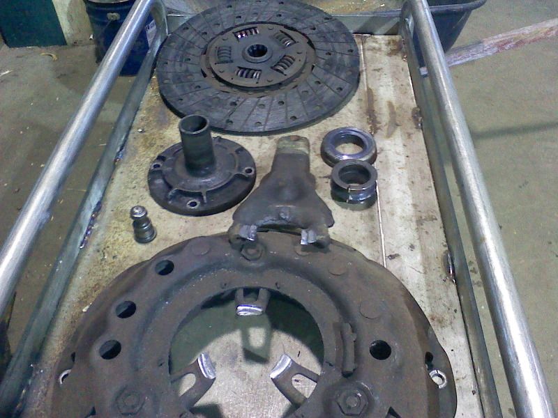

Some pics of the job, and the bad parts:
New / used nose cone:

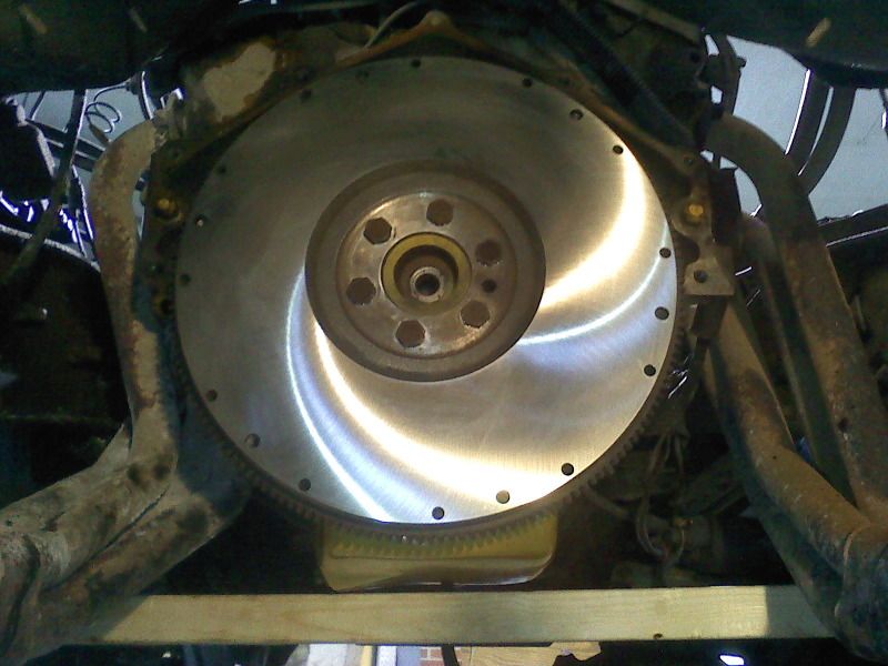

Flywheel ready for clutch:

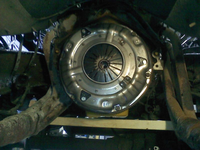

Not a big fan of diaphram style clutch, but its all I could get on short notice. Would have rather had a Borg & Beck style. Have had better luck with them not slipping while plowing over the years:

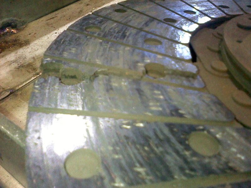

Busted parts, other wise known as scrap metal!
« Last Edit: January 14, 2013, 04:53:41 am by Blazin »

I have had diaphragm style in plow trucks before and had them slip when pushing heavy wet snow, or when stuck givin some to beat it free! I have never had a Borg, and Beck style clutch slip plowing, or wheelin.
Borg and Beck pressure plate is whats in the pics of my wasted parts, 3 fingers. Diaphragm is what is in the truck now, pics of the new clutch.
