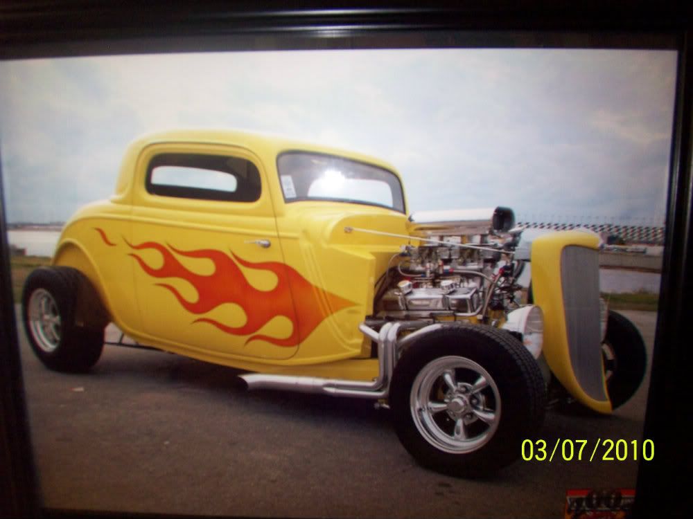

Here's some Tri-tone (tinted clear) flames I did on a friend's car with a $16 Harbor Freight detail gun, you know the Purplish colored one. Each pint of color was over $60 bucks, didn't concern me much. He won the YoungGuy award in Columbus, Oh in 2005 @ the GoodGuys show...the judges didn't seem to notice!
