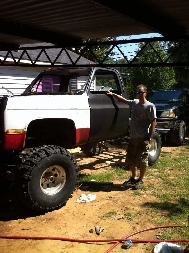

Already been answered but I'm running 37"s boggers with 6" susp lift and 3" body lift. When I first got the tires I had 4" susp lift and 2" body lift... Never scrubbed and I put her threw some rough stuff.

Winky...when I first looked at the pic u just posted I felt a little sick to my stomach and didn't know why..until I looked in the back ground of that pic. You know that if you park those things next to good trucks their problems start rubbing off. But don't get me wrong I will still beat it like the Red-headed ford it is.

LOL my buddies truck. He's hoping my Chevy will rub off some it's built right dust on his truck
