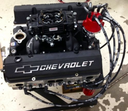

Old Motor
-Slayton
-'85 C10 Standard Cab LWB Weekend Hot Rod
-Small Block 410 Stroker
-Turbo 400

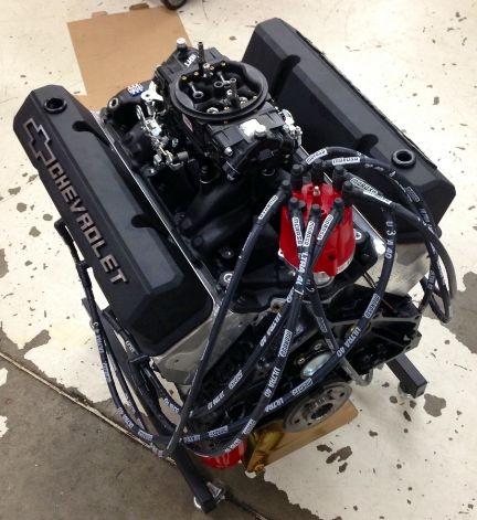

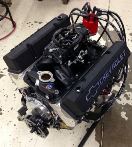

« Reply #4 on: August 13, 2013, 08:58:50 pm »
New Motor on the dyno
« Last Edit: August 13, 2013, 09:01:52 pm by shrncir »
-Slayton

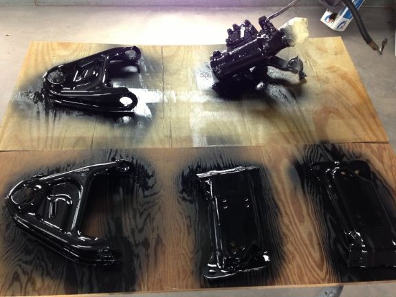

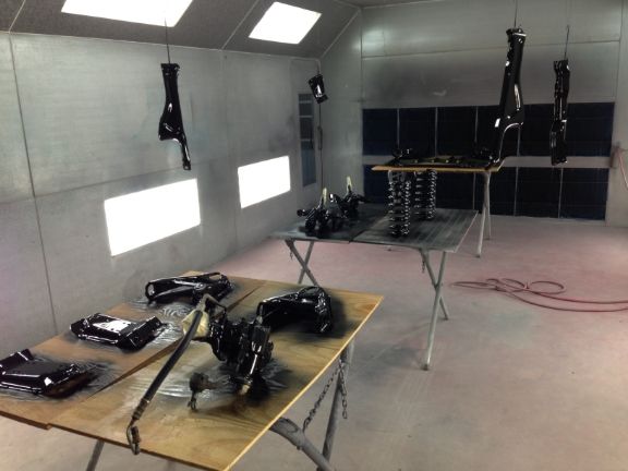

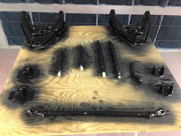

« Reply #11 on: August 14, 2013, 05:26:36 pm »

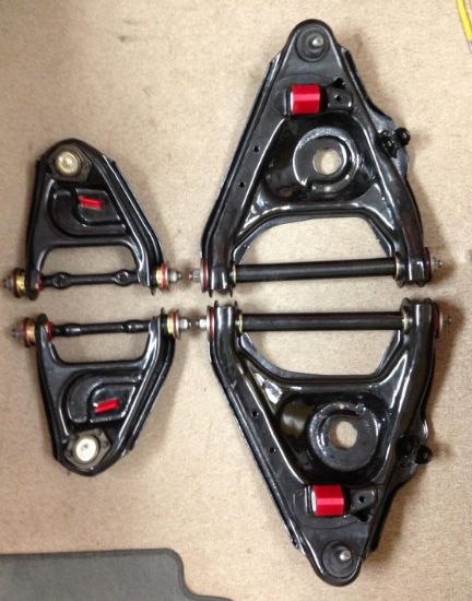

Here's what I got accomplished last weekend, I got my control arms, control arm cross shafts, springs, spindles, motor mounts, center link, and steering box painted with POR 15. I had the control arms and cross shafts taken to a local mechanic to install the Energy Suspension bushings while I'm away at work.
« Last Edit: August 14, 2013, 05:35:46 pm by shrncir »
-Slayton
-Turbo 400

Also got the contol arm bushings and bump stops installed.
