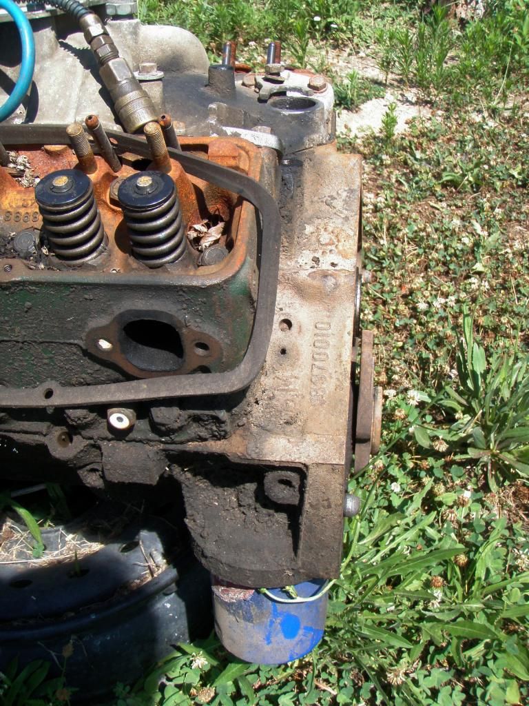

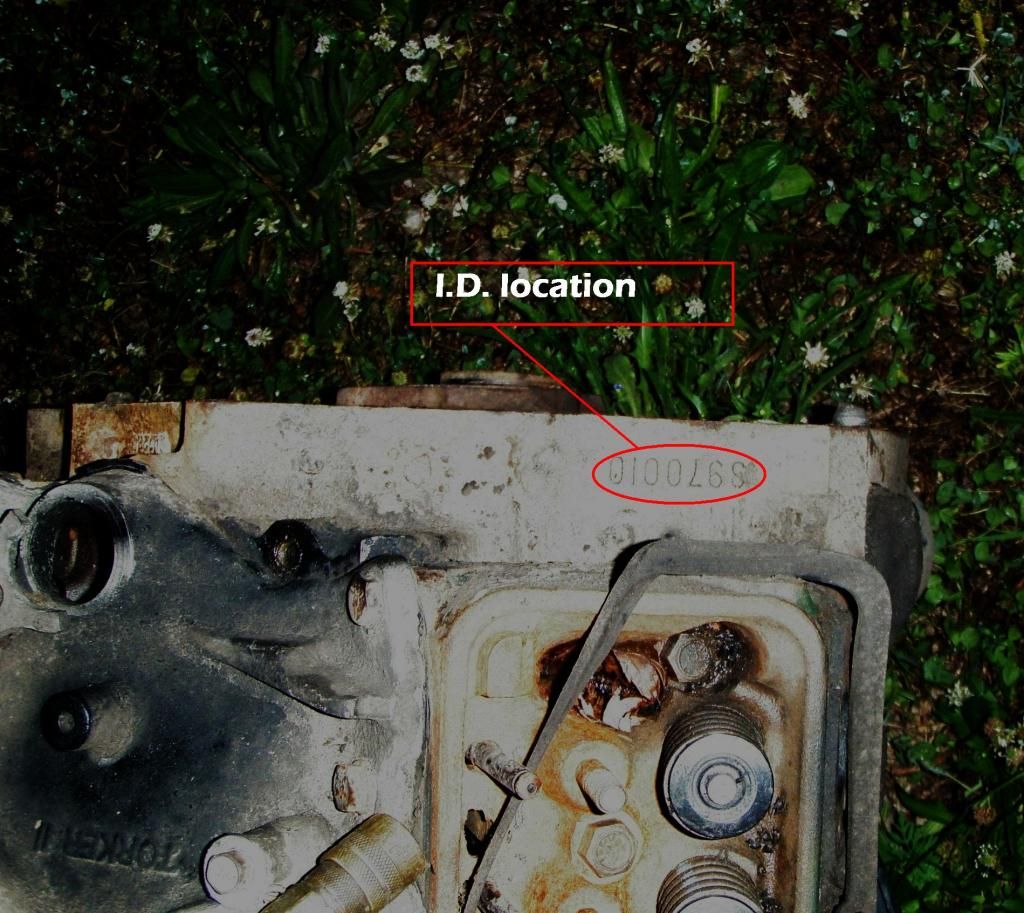

Sometimes a picture helps , It will tough to get to and it's nearly always dirty back there . The carb can be left alone

i take it the pic is shown relative to the location, as in the rear driver's side? how deep down is that step from the lip of the valve pan? where i'm looking, there seems to just be flush sides all the way down from the edge of the valve covers on my motor?
Powerdriver1958
Posts: 71
Kids Mechanic
Re: engine ID
July 23, 2013, 03:44:35 pm »
It won't be easy . A man of my mature stature has to lay across the engine bay with a flashlight and fight the brake booster to see . just ahead of where the engine meets the transmission and directly above the oil filter
