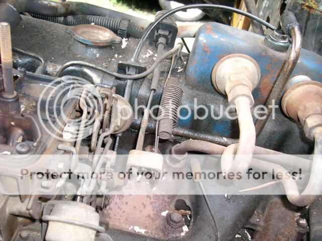

     Can you post a pic before we assume we know what you are talking about, so we can give you the right information.

« Reply #7 on: April 22, 2014, 11:16:24 pm »
Re: emissions on inline 6
« Reply #8 on: April 23, 2014, 07:36:43 am »
     Is it the one that runs vertical in that pic, is that part of your egr valve ?

« Reply #9 on: April 23, 2014, 01:47:25 pm »
It runs from top of valve cover to the head

Bigal04, it looks like you have an integrated head with air injection.  Is there an air pump mounted above the alternator?  From my experience you remove the air pump and plug the lines.  Make sure the plugs seal well or you will have an exhaust leak as the air was pumped into the exhaust manifold to make the early catalytic converters work better.
