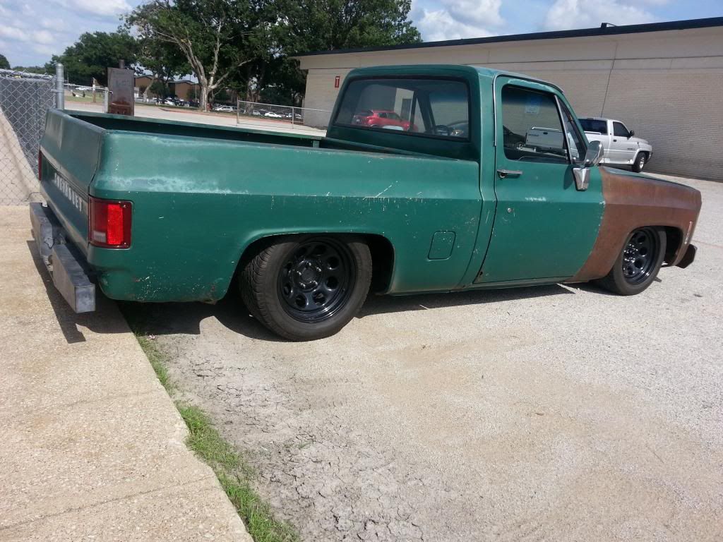

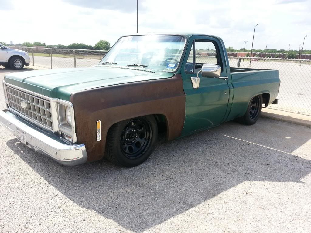

Been a while since I have posted an update, installed Porterbuilt Rear Trailing Arm Conversion and Stage 1 bags in front, with AccuAir setup from Travis from AZProPerformance.
and short vid will post another with bed on when I get it back from shop with new floor pans
https://www.youtube.com/watch?v=aufsECpLF7I&feature=youtu.be
