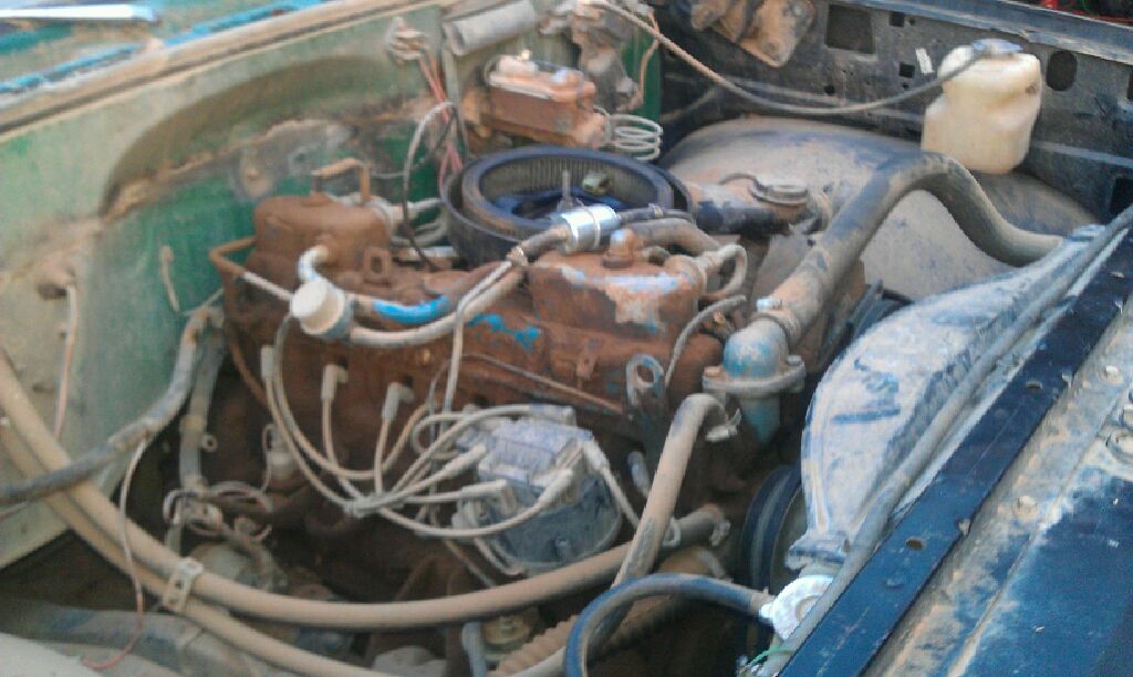

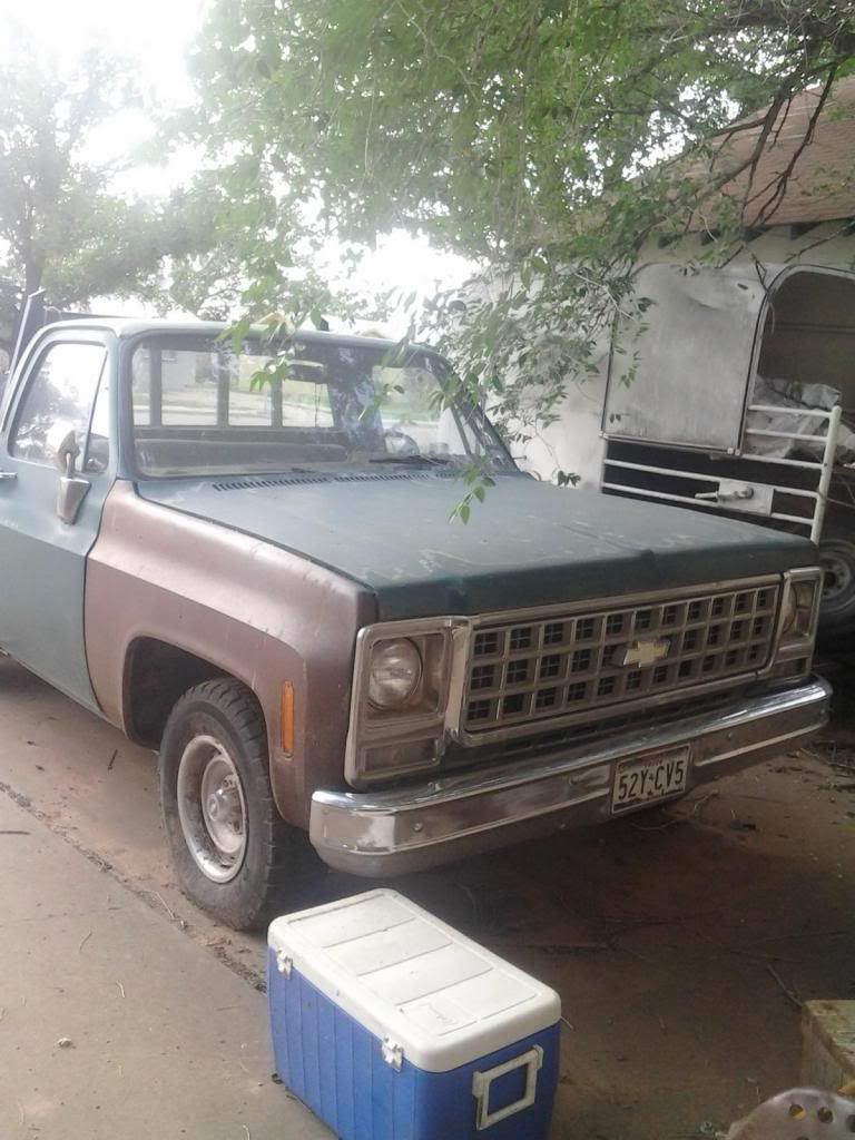

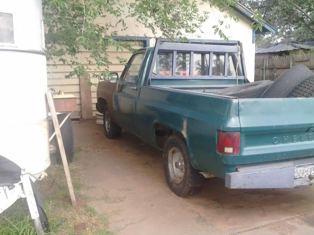

Hello all well new to the site, and in the process of building a truck for my wife and me to enjoy when I am home.  The truck is a 1980 C10 that was bought new by her grandmother, and has been a ranch truck all its life mostly left at the ranch in New Mexico or in Hereford,TX.

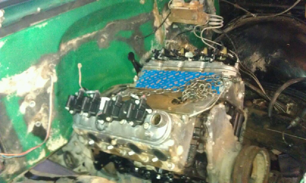

Well now its in Dallas,TX and is getting a 5.3/4L60 swap.
I will be running a stock block and with a Yank 3000 converter with upgraded internal components as well to handle a whipple which will be installed later once kinks have been worked out. Here are some pics so far.

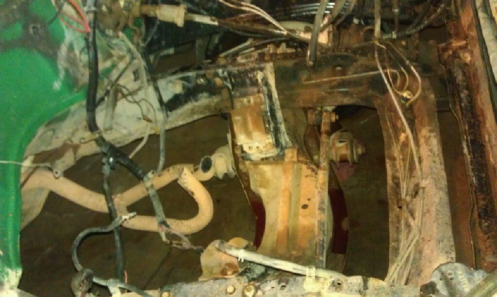

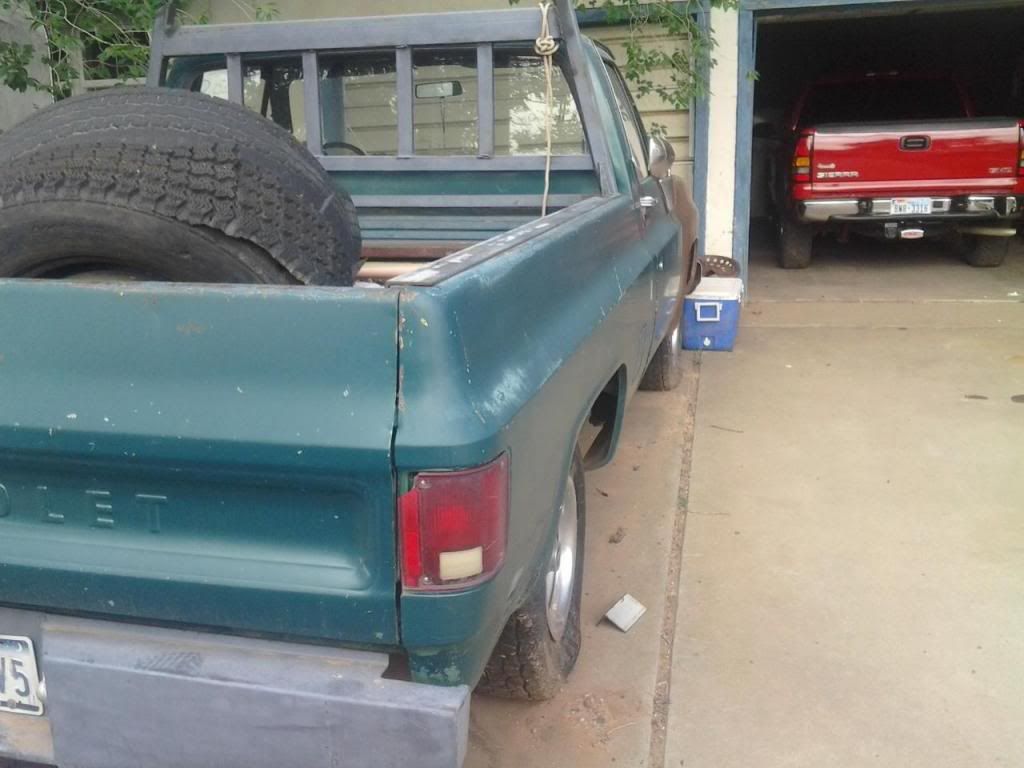

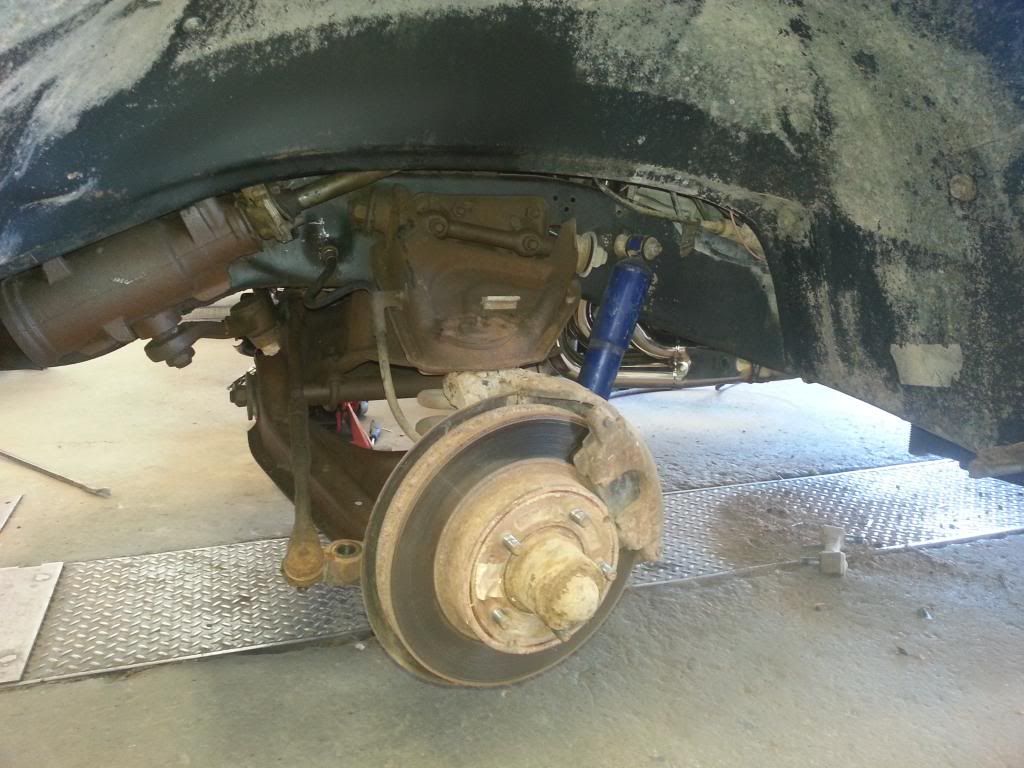

old 250
gone in 60 minutes

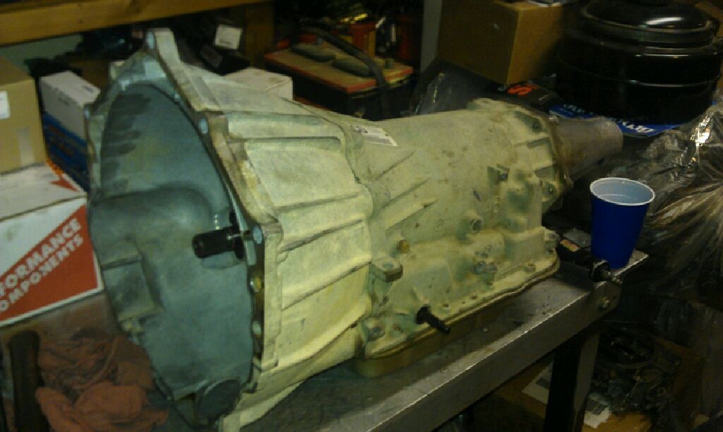

4l60 rebuilt and upgraded

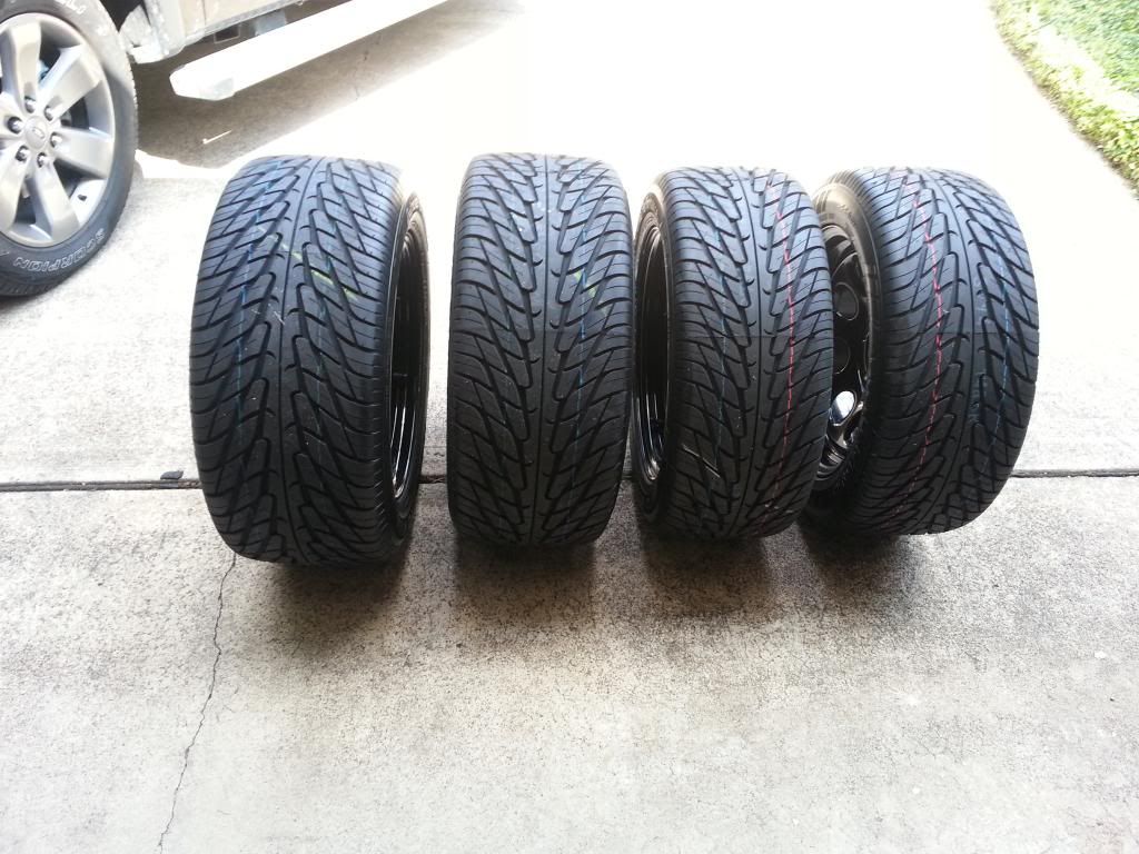

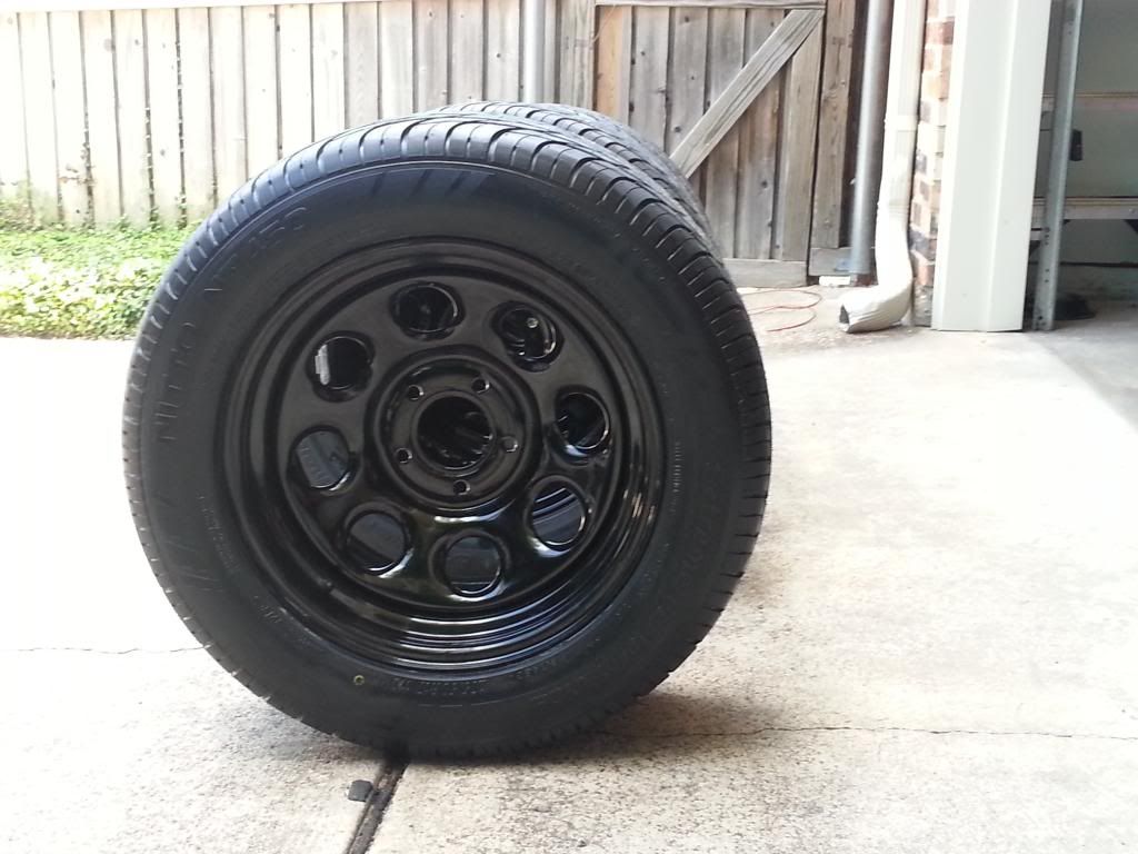

Will be running Cragar Soft 8's 275/50/17 17x9 and 255/50/17 17x8

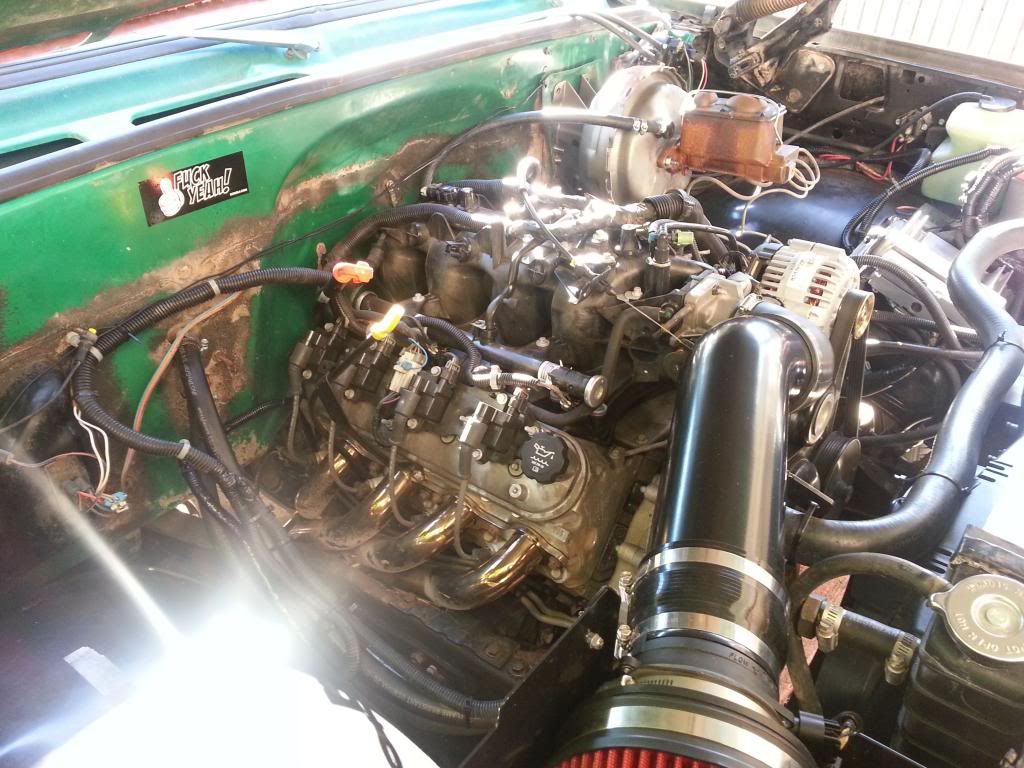

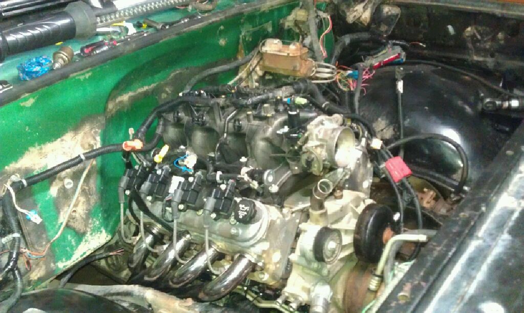

Engine bay is basically done, need to hook up radiator, power steering lines and swap out steering column
I used a radiator from 454 it is aluminum with side plastics new for 175.00 that was out the door brand new, it looked to be 4-row which should cool fine even with a/c hooked up.  It gets hot in Dallas with all the concrete.

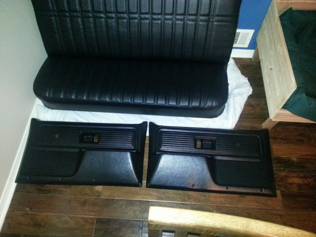

seat flips down and slides forward, cover is from    and padding is from Classic Parts, it is very very comfortable..

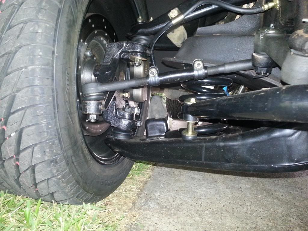

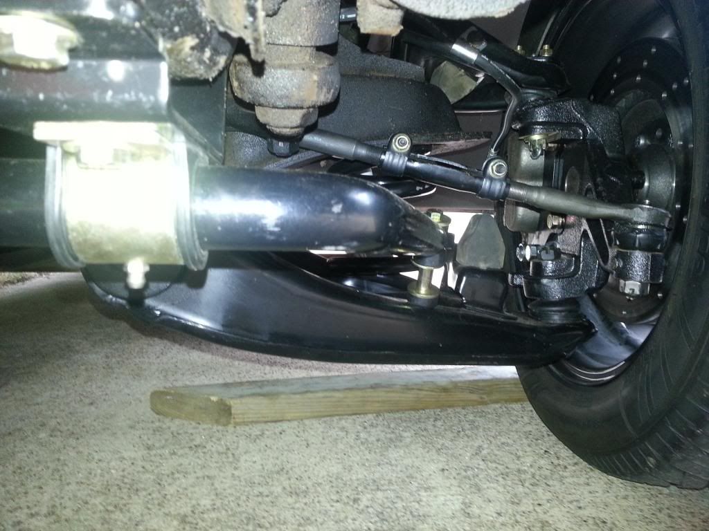

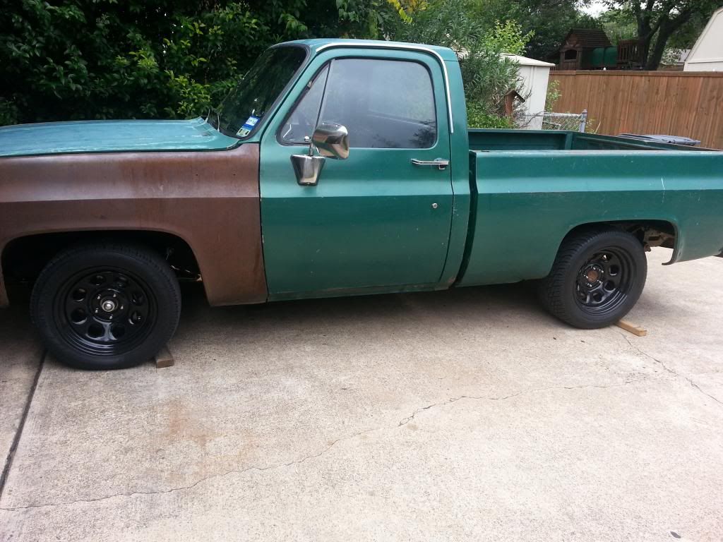

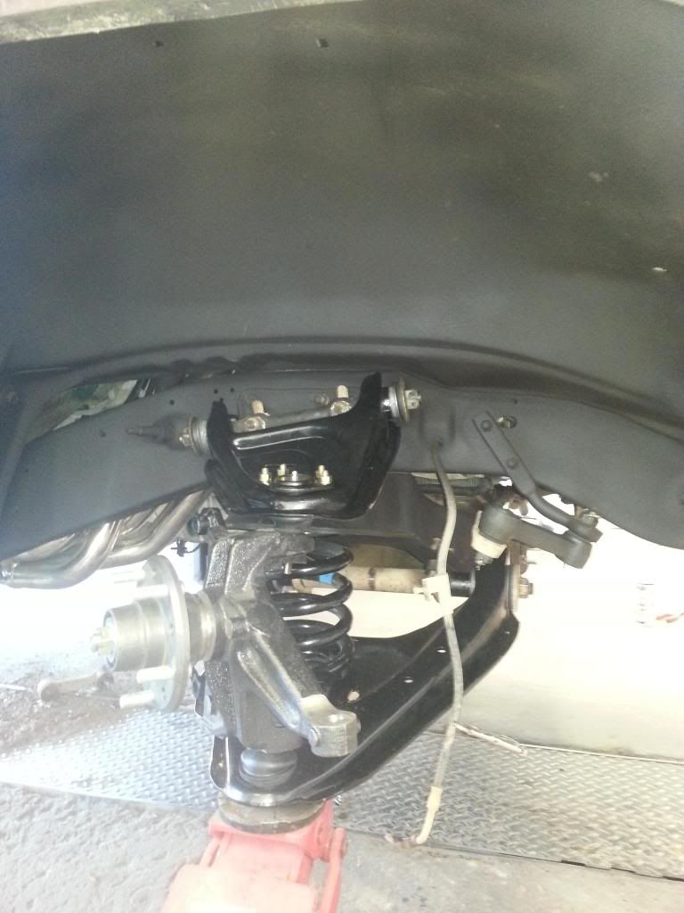

Well been gone at work and not had alot of time to give an update, but so far truck is running suspension is done, except need to add rear sway bar.
13'' McGaughys kit works great , need to install brake booster though, got all parts just needing to sort out some issues with my motor, I have two computers one that is supposed to be for a 6.0 but no efans and on that is for 5.3 that runs fans but gives me surging/high idle so trying to narrow this down.  One issue is that I just got o2 sensors wired up so probably just need to get a good tune done and it should be fine, the truck runs and drives only issues to me are the tune, and the efans are noisy but very work Derale if anyone is interested.
Interior needs a little more work, before I go with Vintage Air install, will post up install one I get to it.
2.5/4 drop
old
new
passenger side
driver side

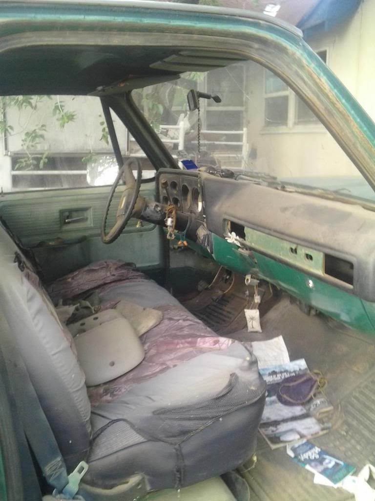

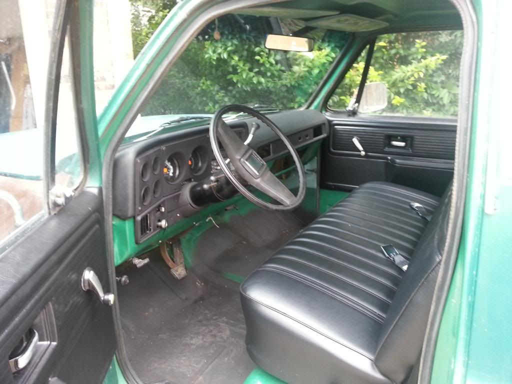

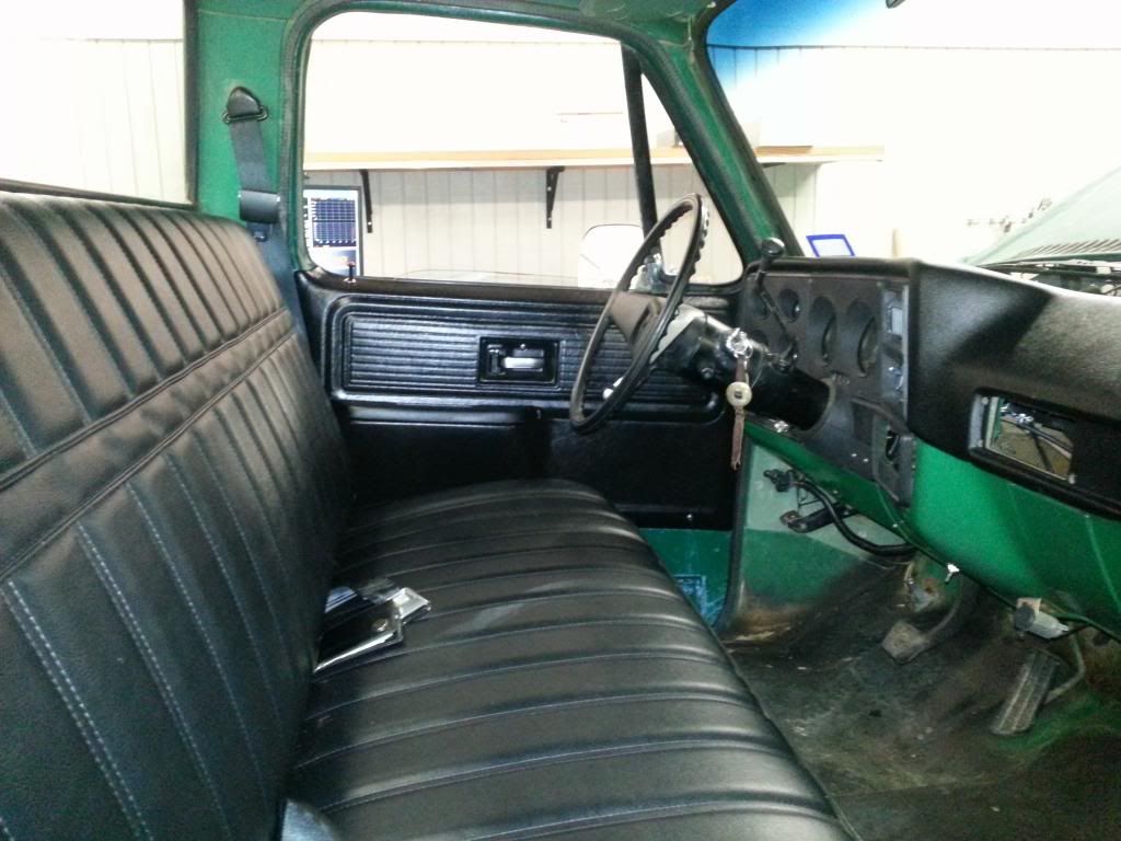

interior still need rubber floor mats

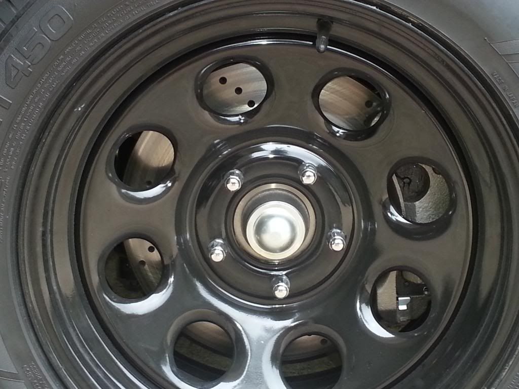

cragar soft 8's and 13'' brakes, these are 17x8' in front

Where did you say that seat cover was from? Love it and need one. Thanks
Re: 1980 C10 5.3 swap
« Reply #10 on: October 15, 2013, 09:57:21 pm »
This site you are on sells seat covers.
you can choose the style you want here and email us for pricing: http://acmeauto.us/gallery/main.php?g2_itemId=4321

I got it before I knew about this site, which has better pricing and honestly is the same cover. The foam is what makes the seat which cost me about 400 for new bottom and top.

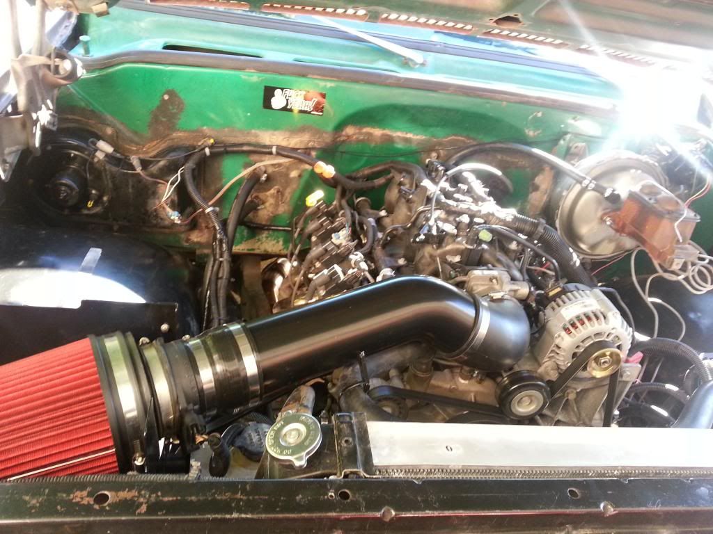

Thought I would add some updated pics, and power info for anyone planning on going 5.3.
Got truck on the dyno and made 267 hp and 282 torque to the wheels, which I am very happy with considering this is a bone stock motor, I did decide to go with the TSP 224R cam which will require larger 42 lb Delphi injectors and PAC 1218 springs which should give me 35-45 extra to the wheels.  I also plan on going to 3.73 gears and a posi in the rear as my truck does not have one :(
At any rate here are some pics enjoy.
Needs carpet and padding but I am happy with it so far.
Strapping her down on the dyno, thanks Exatorque.
And the powerplant
And those are F-Body Camaro headers if anyone is interested
