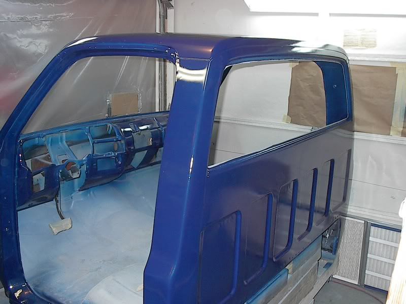

I like single stage because it is basically a clear coat with color mixed in.  I can hammer it on with very little runs.  I sprayed color/clear on my sons truck and found it to be MUCH more work with the prep.
This is with color and clear (small metallics in the blue):
All the black you see is single stage black:
I used Southern Polyurethane paint system
see: http://www.southernpolyurethanes.com/homepage.htm
