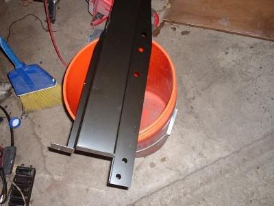

Those pics helped a ton. The replacement piece doesnt have the bottom hole. It only has two which line up with the upper trunion hole, and the center one. I guess I'll have to fab something up. Think it would be easier to remove the bedside to replace the post? I have other patchwork to do on each bedside, so could do it all while they are off since I know I need all new seam sealer anyway, and wated to remove the bed to POR-15 the underside. Thanks a ton for the pics.
Here is one of my new post, so maybe I am looking at it wrong?
Terry
