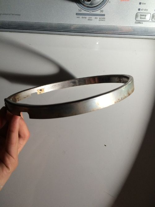

The image below illustrates how the headlamp ring should appear.
Post a pic of what you have.
Offline Macaroni_Sackaroni
  • Posts: 97
Re: headlight lamp circle clamp wont stay on 1975 stepside
« Reply #6 on: October 22, 2016, 11:17:30 am »
well no wonder i couldnt get these to stay on. the mounts for the screws are broken off!   ::)
