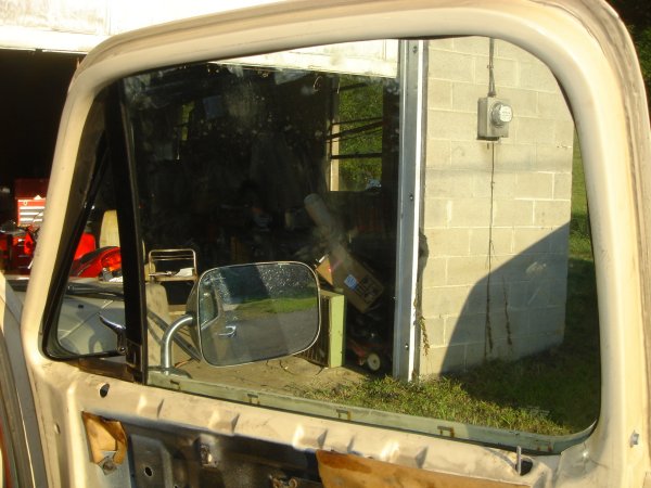

If you are talking about the inner outer weatherstripping that attaches to the door panel and the outside door lip you don't have to remove the window.
If you are talking about the vent channel, it will be easier if you remove the vent assembly.
If you are talking about the window sash channel, you don't have to remove the window for that either if you can get your hand in there to seat the channel.  I just did this a few weekends ago and took some pics for a tech article.

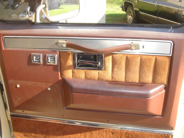

The ones at the top of the door panel and the outside of the door right?
They pull off with a little tug.
The ones connected to the door panel require a little more care since you can break the door panel when the clasp on.
