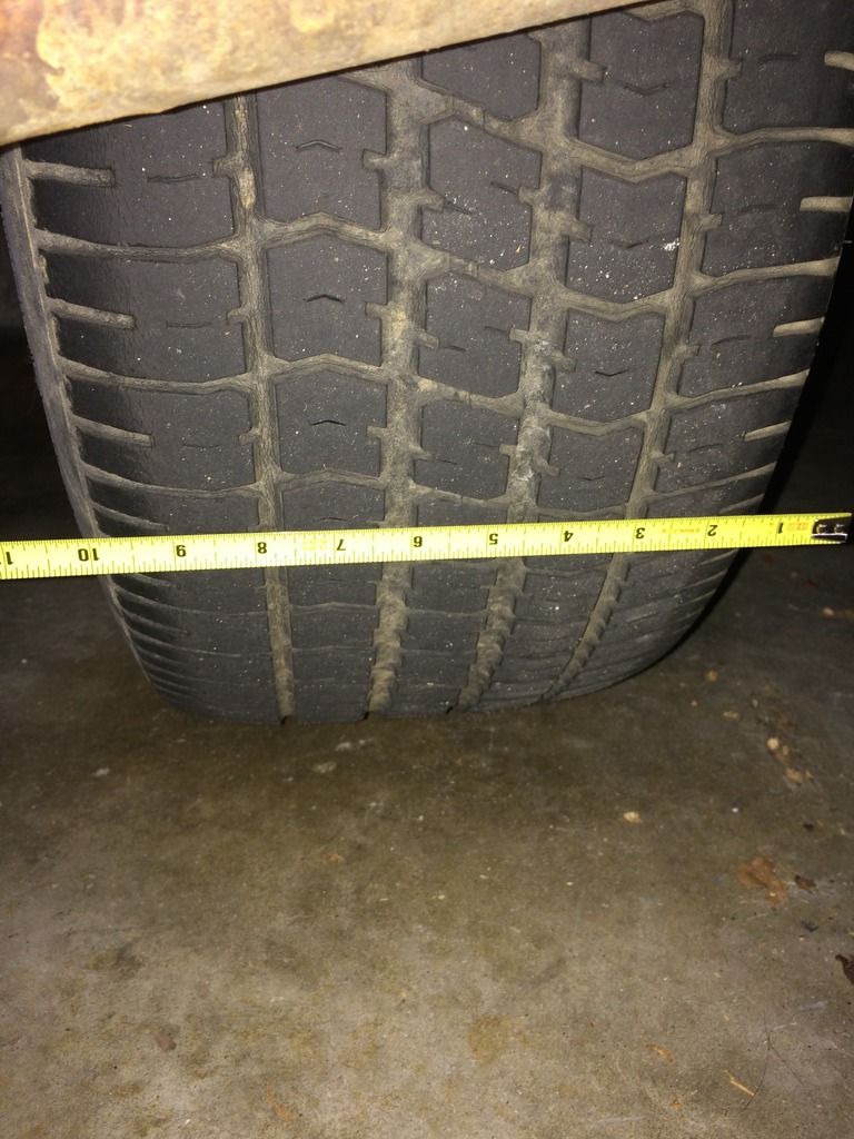

really? 6.5" that doesnt really make sense to me if the rim is 6.5" how would a +10" tire fit on that. i dont know much about tires / wheels.
heres the tire width. its about 10.5

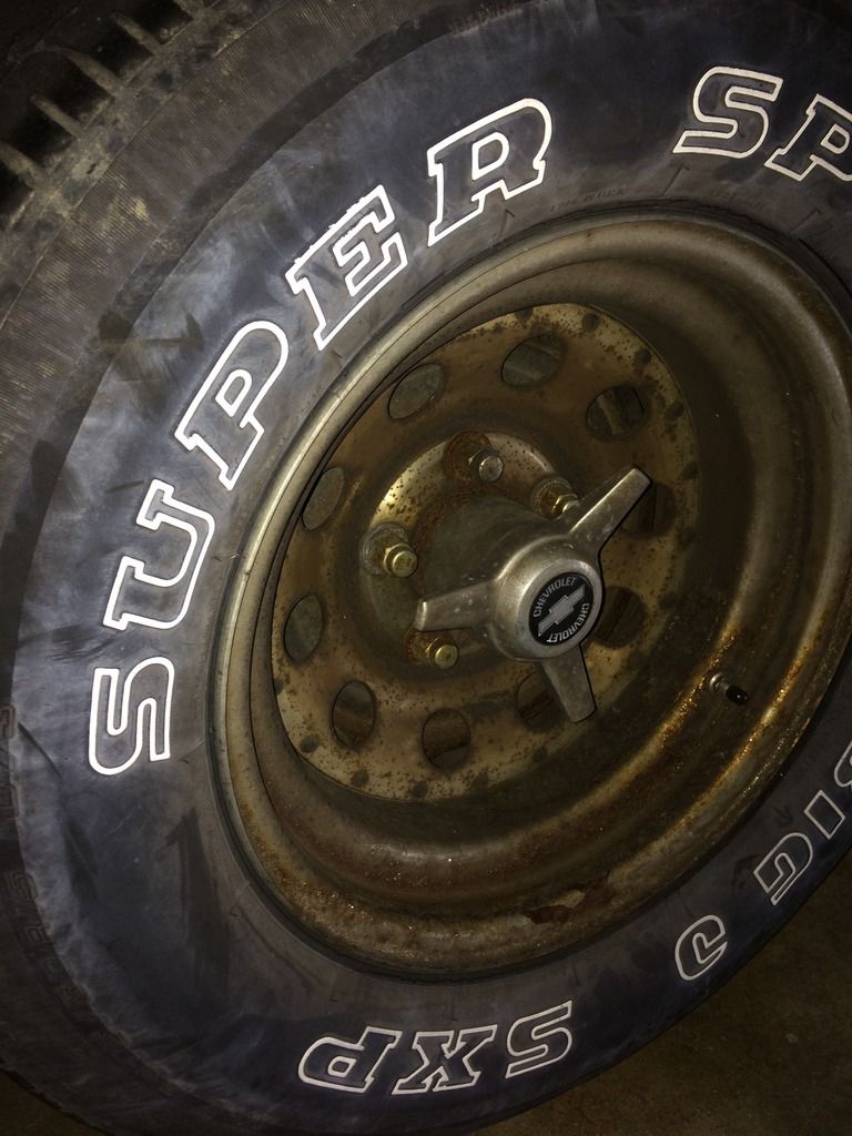

heres a shot of the rim, looks stock. 15"

That is an aftermarket rim, probably 8" wide
are you sure its aftermarket? why do you know its 8" wide?
Re: what is my rim width?
« Reply #5 on: October 31, 2016, 05:51:38 pm »
Once upon a time "chrome" nuggets are aftermarket. Measure the width of the rim or stop in at any tire shop. They have a gauge that will measure the width.

There is also a stamp on the back side of the rim that will show dimensions. My after market shows 15X8 stamped just like rallys.

Those are 15x8" chrome circle wheels as most old school country folks call them. We had a set on an 80s 3/4 lwb years ago with the same size tire as well. These trucks in stock height do good with 255/70s or 275/60s front and rear. Whats crazy is all those cheap steel wheels rust in no time, and are heavy as well, along with being poor made, yet they are still very expensive.
