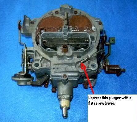

With the engine idling depress the accelerator pump all the way down without opening the throttle. It should stall the engine. If it stalls the engine the accelerator pump is working. Very simple test to do.

Ok, I tried the test.
If I push the plunger down slowly, it will bog down, but won't die at all.  If I push it down fairly quickly, it kills it.
Does that sound like a problem with the accelerater pump?
