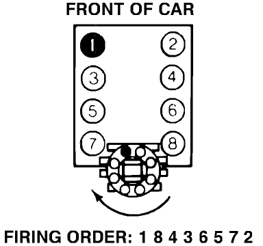

Posts: 19255
Firing order
April 16, 2006, 08:48:00 pm »
Well it really doesn't matter but the firing order is as such...
But are you saying you have no spark now?
