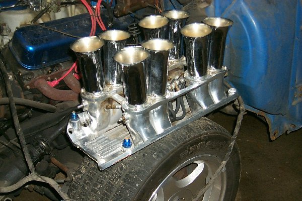

I am partial to these: :D
If I was still doing carbs I would probably go for the Performer Air Gap, plus if you are happy with it.....

that is sooo cool!!  I'd like to switch it to electronic FI,like one of the Big Shot systems and strap on a pair of 88mm turbos..how cool would that be?
I do like the air gaps though..
