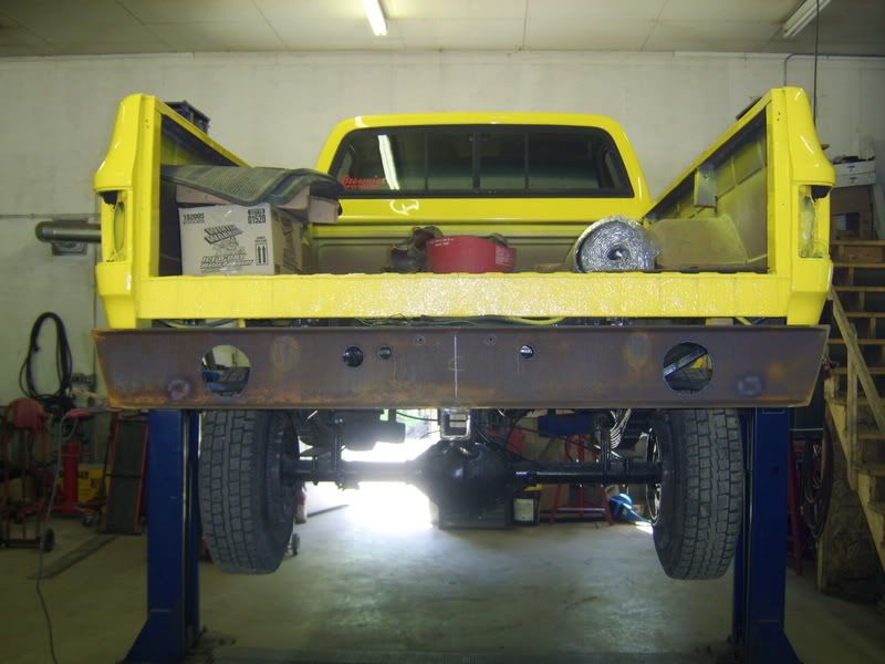

Just trying to remember...Who was it that made a set of bumpers using a old "I" Beam? thinking about doing it myself and just wanting to no if he would like to post a few pics..I was going to use a "I" beam as my foundation and add a winch and brush guard

I built my rear bumper from I beam. I didn't take very many detailed pics though.
The large round holes are for rubber mounted sealed beam tractor lights.
The odd ball hole off set to the left is for my 7 prong trailer plug.
With POR 15 on it.
With SEM brand spray on bed liner on it.
I bolted stock bumper brackets to to factory mounting holes, I cut them off a few times before I liked where the bumper sat in relation to the bed. I already had a class 5 hitch bolted on the truck. I welded the I beam to it and ran 45 degree braces in from each end to the hitch. Now the hitch and bumper have 10 bolts mounting it to the frame, instead of 6 and 4.

I love them bumpers! I'm going to be picking up two 10ft ones tomorrow from local scrap yard...I just have to pay for scrap value Then I'm going to attempt to mount a winch box...In about the same spot u have Ur license plate holder ..And then i was going to take some chrome molly tubing and build a brush guard...Then lets see some one back into my front bumper again!!!! lol

If it was a wheeling truck I would have mounted the plate off to one side, and put a roller fairlead where my plate is, & and a winch under the bed. Its a plow truck and I have an 8000 lb winch that goes in the 2" receiver if I get hung up. Keep it in the tool box otherwise. I have a 2000 lb electric crane that mounts on the plate in the corner of the bed. I wired it so it can be unplugged and the winch plugged in.
