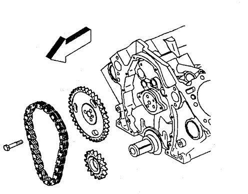

The retainer was available from GM. Not sure if still is. You can eliminate the retainer and go with a cam button. Summit sells a timing chain set with a torrington bearing. all you need is the lock plate and the cam button. It's dirt cheap I'd go that route. This is what I just did with my 454. I believe I posted pix but I can't remember. The set up you have there looks to me like it's not going to work unless you machine down the cam gear. Then you will have to make sure the chain alignment is correct.

In these pix you can see the early version of the retainer and the later version which I think they changed around 1997 1998 ish.
