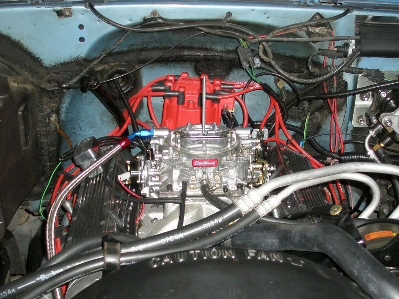

Yep, but air cleaner clearance might become an issue, as it did for me.  If I had it to do all over again I would go with a small cap pro-billet street dist and a 6AL box.  Little more $ overall, but a better package, IMO.

The Large Cap MSD's shouldn't be any larger than a comparable HEI.

« Reply #44 on: August 25, 2008, 03:19:12 pm »
Yeah but he says his air cleaner wont clear, which is also what i was kinda thinking. I will just have to go with the one he recommended cause i dont wana deal with all that.
