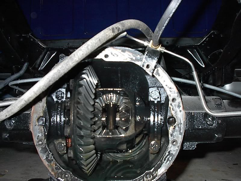

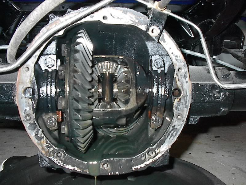

Hey guys, it's been a while.  I had to get away from this project for a while - getting way to overwhelmed.  Now that I am recharged........I have a question.  Take a look at the following pictures - does this rear have positraction?
I know it is a 2.73:1 ratio.  Will this be able to pull say a 3000lb boat or should I change out the rear end?

no, not posi.
yes, you should be able to pull 3000lbs.

Definitely an open carrier.
Welcome Back!
