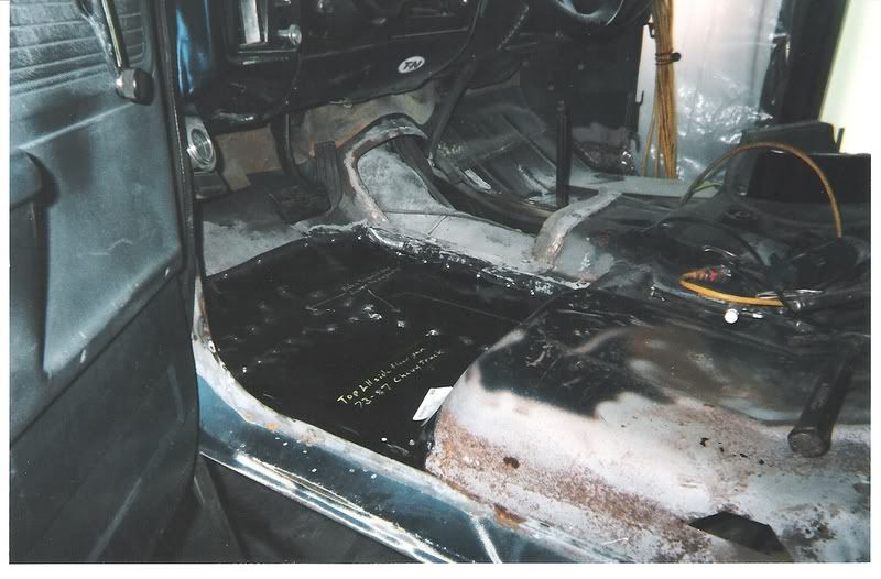

Trying to get an idea of how much of my '79 K10 floor I need to save, and how much of my '83 C10 floor I don't need to clean up, for teh eventual swap in the Spring. Anyone have 4x4 floor pics they can post? I'd appreciate seeing them, thanks.

Re: Need 4x4 floor pics please
« Reply #4 on: December 11, 2008, 05:59:47 pm »
Here is some of a floor I redid a few years ago.

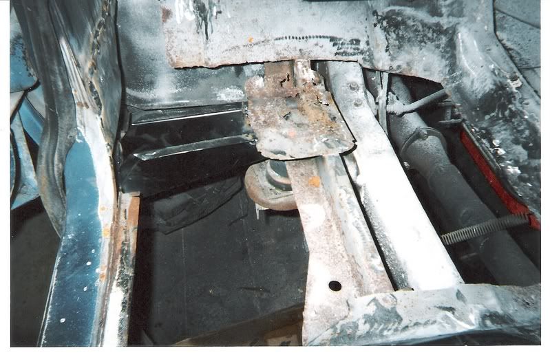

 Heres a pic of the under seat 4X4 hump. This piece was cut from a 4X4 cab floor and used to convert a 2WD cab to 4X4, it's part one in the hole you need to cut in the 2WD cab floor. It is installed from underneth and bolted/screwed to the floor and the transmission hump bolts in last from the top.
This is the hole that was cut in Old Rusty's cab. I'm replacing the cab so I will do the same thing to the new  2 WD cab(I could weld it in, But its only a mudd truck)
