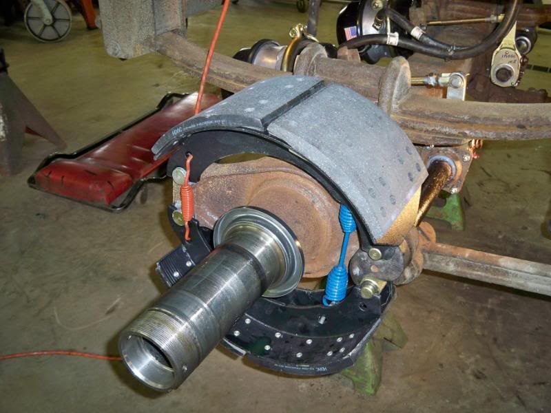

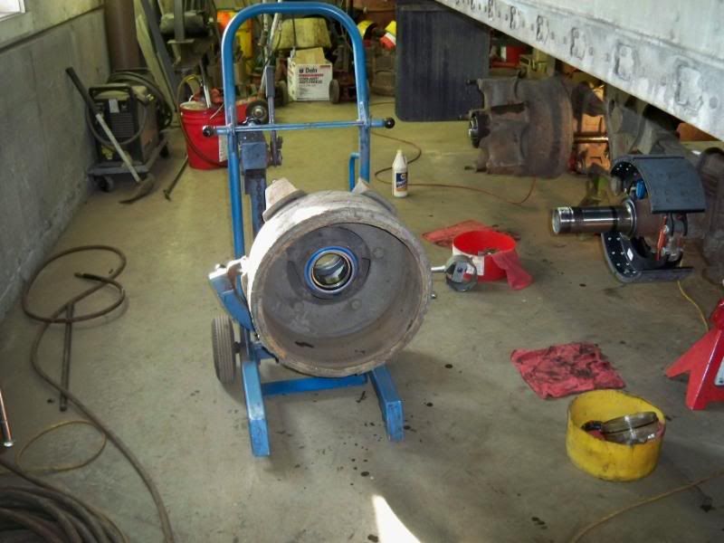

What I did today.
16" diam. x 7" wide.

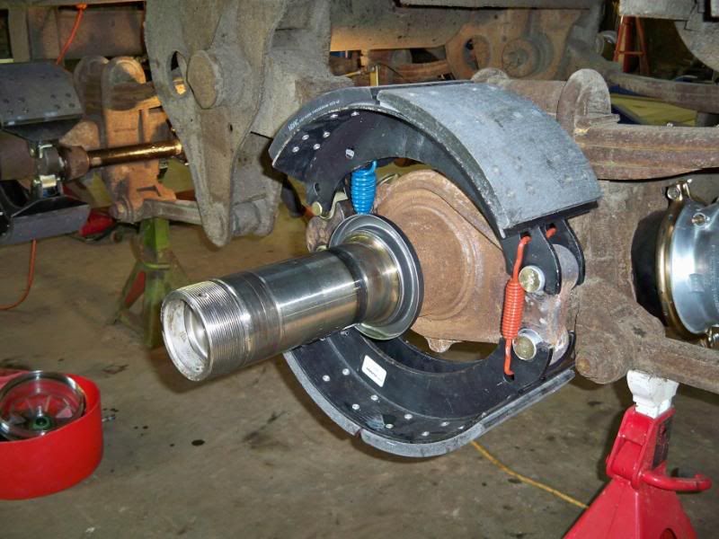

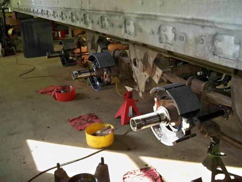

Air brakes are so very very simple. They should be an option on 1 tons. Hows a $4,000.00 dollar brake job scare you? All new air cans, slack adjusters, new brake hoses, release / set valves, S cam bushings, anchor bushings, rolls, hardware, brake shoes. Didn't replace drums, and S cams, they are still within specs. Plus the guy doesn't want to spend any more money. Wood chip trailer, it does about 10 to 15 loads a week, he has two trailers.

Is the 4K just in parts, or does this include the labor?
Re: Brake job ( updated better pics )
« Reply #7 on: February 10, 2009, 06:53:32 pm »
Parts and labor.

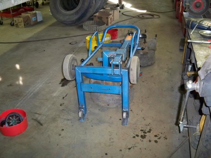

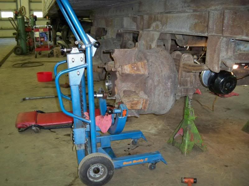

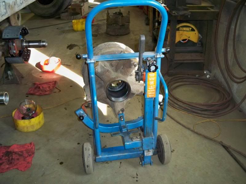

each one of those hubs probably weigh as much as I do.  ;D
« Reply #9 on: February 10, 2009, 11:10:33 pm »
The drums are about 150 lbs, and the spokes are approx. 100 pounds. Depends on how much of them has rusted away!! Thats why we have the Back Buddy. Have one for hub pilot drums too.
