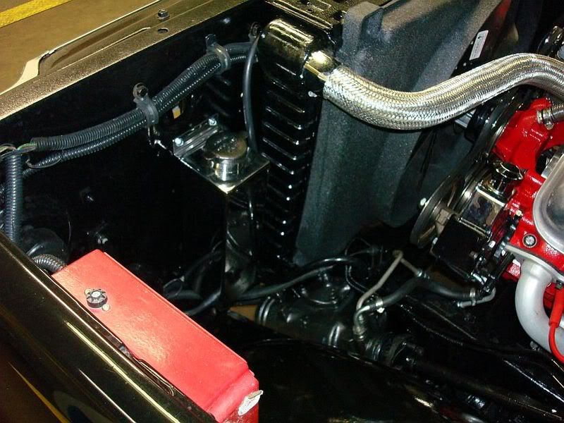

« Reply #2 on: June 24, 2009, 06:59:11 pm »
It's not a close up but you can see how I just modified the stock bracket to work with the headers sorta.

Re: BBC Power Steering Pump Brackets - Location and installation
« Reply #4 on: June 25, 2009, 04:30:25 pm »
r u installing this setup on a SBC?
if so heres a few pics of my setup.
had to use this setup since my heads dont have accy holes.
and i had to modify the back bracket and cut the arm off that goes to the motor mount hole.
plz excuse the cell phone pics.
click to enlarge.
