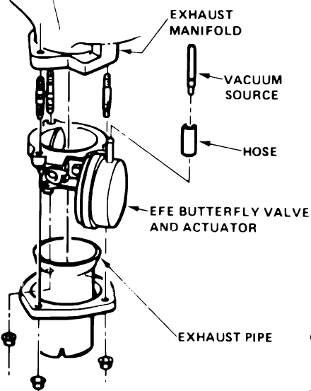

Got a pic of riser lever today.
Still not sure what is the open position
Any help would be great.Thanks

Up should be closed. Why not take it out and gut it?

Thanks Vile , so is it closed in my pic do you think?
Hard to tell for sure from the diagram but it looks like if
I push the lever down 'towards the front of the truck'
it will be open?
I moved the lever and took another pic of the
lever in the position I hope is open
