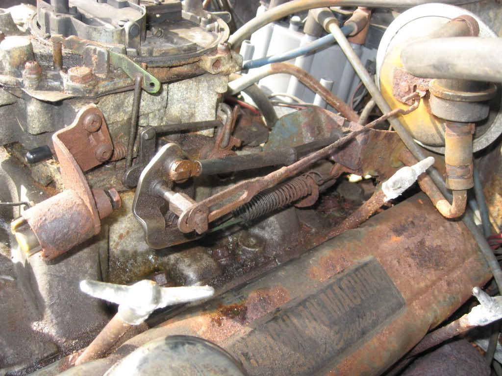

I bought a new detent cable for the 82 (350 th350) and used my 73 as a reference when ordering it at the local parts place. it fit right into the transmission, but when i ran it up to the carb it is too long by about 2-3 inches. are there different lengths of these cables? or do i have the wrong linkage on the carb??
pic for reference... ( i know they are blurry but you get the picture)

can anyone help? maybe it's the wrong mount on the intake? i can't figure it out.....

Maybe post up a pic of the bracket? To me it does look a couple inches to long. I'll check in the daylight how the kickdown is rigged on my '73.

true, here is a pick of that side of the motor that shows the bracket. the detent cable mounts to the same bracket as the throttle cable. (older pick before i cleaned things a bit) thanks
