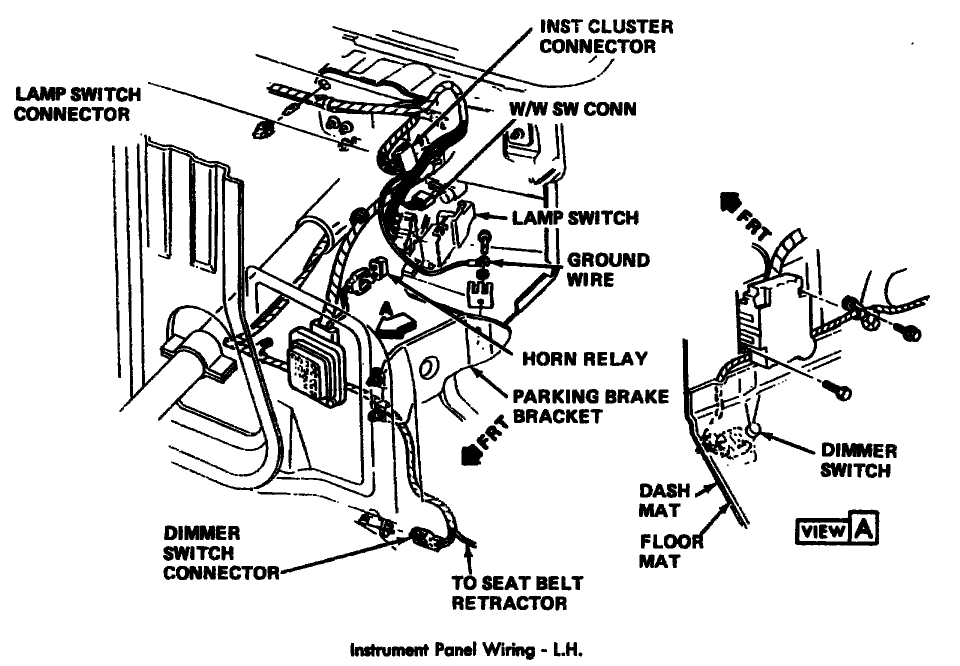

It's up near the steering column. Let me see if I have a pic. First check right at the horn with a test light. If it lights up when you press the horn, replace the horn. Then check the flat connector at the base of the column and make sure all the pins are seated and the connector is tight. I'll look for a pic.
Re: 87' R-30 Horn issues
« Reply #2 on: October 31, 2009, 09:07:42 am »
Here ya go...

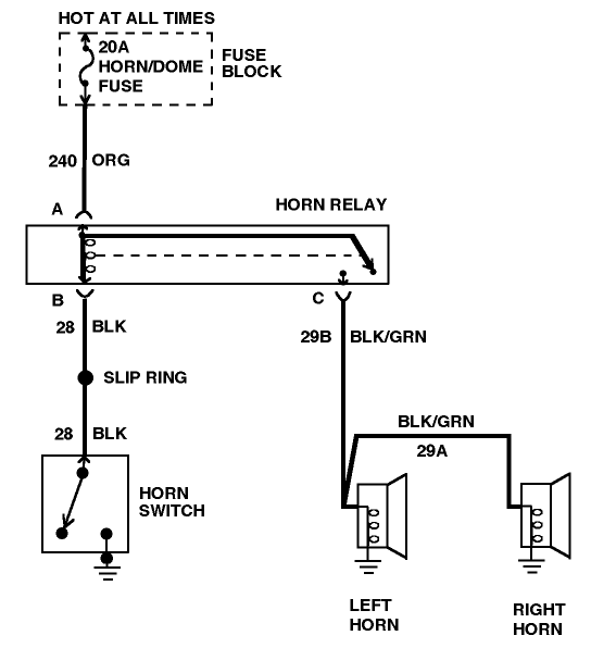

OK so I replaced the relay since it was the original one. I then checked the horn for power. No power is going to it. I checked the pin connector to make sure the connections were tight. While I was at it I coated all the connectors with dielectric grease since some of the terminals had some corrosion on them. The horn still doesn't work.
Have I missed anything? What else should I try? ???
« Reply #4 on: October 31, 2009, 09:28:55 pm »
No power at the horn when you push the button right?
Take your test light to cavity A of the relay harness. It should light up.
Hook your test light to power and probe cavity B. Press the horn and it should light up. If it doesn't the problem is in the column
